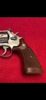

I recently aquired a Model 66-2 stainless 357 mag, square grip, in excellent condition. It has a set of aftermarket grips on it. Can anyone give me a picture of what the proper factory supplied when new grip would look like. Also type of wood, etc.
Thank you
I think some had walnut Magna grips but many had Goncalo Alves Target with speedloader cutout.

Stocks on my 66-2:
Mine came with Target grips. The adjustable sighted models generally came with Target and the fixed sighted ones came with Magna.

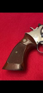

Mine is from 1988 but I bought it used and didn't get a box with it. I think these were stock but am not sure. 66-2 on the bottom and 629-3 on top.

Posts #3 and #5 are Goncalo Alves Target with Speedloader Cutout
Post #4 is walnut Magna
Post #7, top gun is N-frame Goncalo Alves Target and bottom gun is K-frame square butt Combats (and these are -NOT- original equipment on any 66-2)
