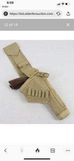

I am looking for a correct WWII holster for my Aussie S&W Victory model. I have searched this forum and most examples I see are leather, yet I beleive it should be a webbing material. Most military holsters I see are quite simple: webbing style, belt buckle and a flap held with a stud. However, I recently saw this very cool holster for sale with a gun at an auction. Can anyone comment on its autheniticity, which country may have issued it, was it WWII or other conflicts? I have actually never seen one for sale anywhere.
However, most importantly, what would be the correct holster for my WWII Aussie victory?IMG_3117.jpg

The holster you posted was designed for British Army Royal Armored Corps soldiers. I suppose it is possible that Australian soldiers in an armor unit might have used that style of holster but it does not seem likely. I am not aware of that model holster having been manufactured in Australia.
Australian soldiers in WW2 primarily used 2 other holsters. Foremost was a web holster in the Pattern 37. That holster was manufactured in Australia as well as in Canada , the UK, South Africa and maybe India. The second holster is a leather version of the P'37 holster manufactured in Australia. I have examples of both in my collection. I don't have access to them at the moment or I would post some pics.
Hope that answers your question.
Regards,
Charlie
Thank you gentleman. Absolutely spot on feedback and information. I am chuckling a little, because no mater how narrow the question, someone usually has the answer. Amazing!
