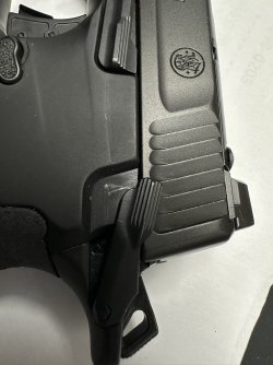

mine has the same wear mark but I believe it is caused by engaging the safety lever.
with the safety off there is no possible way for it to contact the slide.
Just normal break-in wear.....no worries unless it becomes a problem later which I doubt.
Maybe you're right, and I should give it some time.
It shoots fine and the safety mechanism works.
I tend to ride the lever while shooting so that's probably aggravating the wear.
Perhaps it's just scratching off the finish.

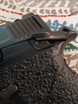

Does your safety lever have a bit of side-to-side play?
when my safety is on there is no movement at all.
when off there is a tiny bit of movement up and down.
also....there are no wear marks on the other side of the barrel so the ware marks has to be
from engaging and disengaging the safety as I only do it with my right thumb.........
the other side.....
OK. Thanks.
When engaged, the left lever has a bit of wiggle, and it hits the slide while thumbing it up and down.
I don't notice any wear on the slide, but it's certainly hitting it.
If I press on the lever with my thumb while pushing it up it gets stuck on the slide, and I can't engage it to the safe position.

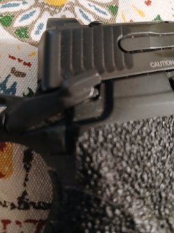

Strangely, my EDC CSX shows just a bit of wear on the right side of the frame under the safety lever. The safety levers on the CSX are a little flimsy compared to a 1911 or Browning Hi Power in they are fairly long & thin and have a very small area that attaches the lever to the pivoting shaft. My spare CSX has been shot about half as much as my EDC and it shows no wear under the levers at all.
The attached photo is of the right side of my EDC CSX.
That is strange.
The right side of my CSX E shows no signs of wear and can't be pushed up against the slide.
I guess there's going to be some slop in the tolerances in an under $600 2011(ish) pistol.
Everything else is great. (Trigger, reset, recoil, accuracy, etc.)
I'll run it for a while and see if it gets worse.
The wear doesn't bother me as long as it remains functional.
