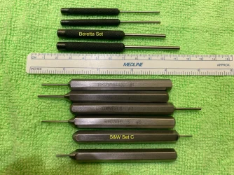

IF you cannot easily source them, you can modify a common punch to complete the task. Either a brass or steel parallel pin punch host with Dremel ball to create the "cup tip" OR use nail finishing punches that have a cup tipped surface.
FYI- Most of the S&W & Beretta punch shafts are so small in diameter for their length, they will more
often than not, buckle to use with force application; you need two sets !! short shaft ones to get the pins moving then the longer ones to complete pin displacement. The nail set punches can be a good
alternative to the requisite "short" shaft punch.

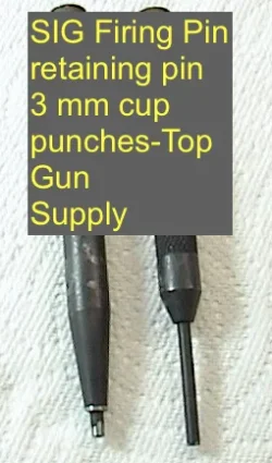

Here's a few from my bench.
CIMG4638 copy 2.webpDSC00227A SIG FIRING PIN RETAINING PIN CUP PUNCHES SHORT LONG copy 2.webpDSCN1187a copy 2Gunsmith Cup Tip Punch Brass Fabrications New England Parnder Project copy.webpDSCN1193a copy 2Gunsmith Cup Tip Punch Brass Fabrications New England Parnder Project copy.webpGunsmith Punches Cup Tipped Beretta S&W Set C 09,04.23 ANNOTATED copy 2.webpIMG_8574Gunsmith Punches Cup Tipped Beretta S&W Set C 09,04.23 copy.webp

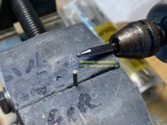

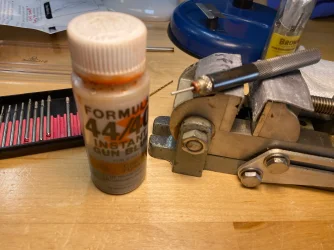

You can fabricate small cup tipped punches from Brownells replaceable pin punches, which are essentially hard ejector pins. A Dremel ball tipped bit to the end of the punch. Done.

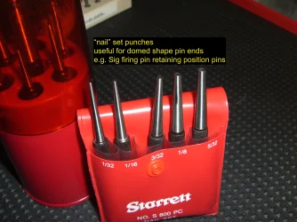

Starrett has never made parallel punches with a cup tip. WTF?. IF they made them, I would own them. The cup tipped ones are tapered nail setting punches to be re-purposed as "starter" punches to get the domed head pin moving for a few millimeters.

IMG_8322Gunsmith Center Staking Punches Prick Hammerless Snap-On Mayhew 08.17.23 copy.webp
