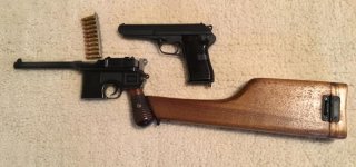

When I first got mine almost 40 yrs ago, ($89.99) I didn’t have a source to get any ammo to feed it. I did get a bunch of unprimed .30 Mauser brass from Greyback Wildcats and worked up a load that both my Fed Ord C-96 and VZ 52 ran perfect with.
I’ve never shot commercial ammo in either but with my tuned up reloads the 52, (and C-96,) have always functioned correctly. I’ve kept it stock although I was tempted to get a 9mm barrel when they were readily available.
