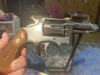

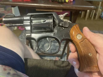

Traded into this yesterday. Young man posted on a local trading board. I gave a M&P gen 1 in 9mm. It had the black grips on it that were falling apart and very dry sticky, my hands were black when I got home, so I put the only other K frame grips I had in it for now.
IMG_6852.webpIMG_6840.webpIMG_6851.webpResized_20260504_115652.webpIMG_6855.webpIMG_6854.webp

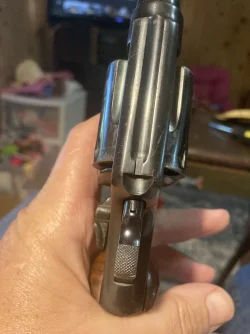

It’s a 38 special, K Frame, 5- screw, 2.5 inch barrel. It has a plugged lanyard hole. I’ll post pics and see what y’all can tell me. IMG_6840.webp
    1.3 MB
Welcome to the Forum.
I hope you didn't have much invested in your 9mm trade gun. You now have a WW II era British Service Revolver (BSR) that was originally chambered in .38 S&W, which is different from .38 special. It probably shipped with a 5" barrel and the barrel has been cut down.
The cylinder has been rechambered to .38 Special. Since the original chambers are larger, fired brass may swell and at times, split.
Sorry to be the bearer of bad news.

Welcome aboard! That looks like a WWII BSR vicoty with a cut barrel. Cylinder may have been reamed to accept 38 special as it should originally have been 38/200 (38 s&w). BSR is a British Service Revolver or lend/lease.
I seriously doubt it was a L/L unit. We cannot see the full serial number, but the lack of a property stamp on the top strap is an indicator, as well as the location of the "flaming bomb."
It is almost certainly an early British contract BSR, which has been modified as noted above.
After the war, many of the BSRs were turned into "snubbies" for the American market and sold very inexpensively here. The missing lug for the muzzle end of the ejector rod is what keyed me to my analysis. I have owned a few of these. As it was very easy to lengthen the cylinder shell space to allow the longer 38 special, it was a nice inexpensive carry gun.
This is not to say that it is definely not a shortened model of 1905. Otheres, here, with better eyesight can probably give you a postive identification.
The only interest I would ever have in putting one of these atrocities in my safe is the fact that it's similar to the model that Oswald supposedly used to shoot the Dallas cop in the theater after the JFK assassination. I see fools pay hundreds for them at auction because they haven't educated themselves enough to see that the under barrel locking lug is missing or that the front sight has been soldered on over the patent stamps. I might give $200 for a very nice example based on the LHO/JFK connection, but would never dare shoot one. If reamed from .38 S&W to .38 Special, the brass will swell and likely split, making it unusable for reloads. The difference in bore diameter (.357 vs .360) would make accuracy virtually impossible.
When these were released by the Brits, modified like yours, then dumped on the US market in the 1950s, they sold for $20-25 in the backs of gun magazines.
You traded into a piece of WW2 history that was frequently used for concealed carry back in the day. 38 special ammo is readily available; just be aware of the split case likelihood as others have mentioned. Avoid +P loads and Welcome to the Forum!

A plugged lanyard hole for me would be the biggest indicator, as mentioned also the lack of a lug.
Sir as an effort to understand and educate myself, can you tell me why you say that, not that I doubt, but I have no clue and I’m having a hard time w some of the things I turned up in my search.
The first clue is the cut barrel and an unsecured ejector rod. Many of these BSRs still have the "38 S&W CTG" marking on the barrel. A soldered on front sight is another indicator, especially a tinny looking ramp sight. Some will be stamped on the frame ".38 special".

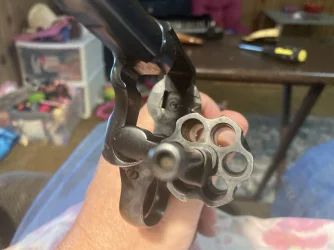

A check of the chambers will show two "rings", one for the original .38 S&W chambering and then a second "ring" closer to the front of the cylinder. This second "ring" is where the cylinder was reamed for the .38 special cartridges.

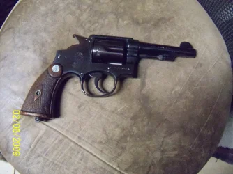

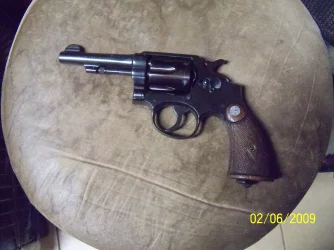

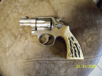

Not all WWII BSR revolvers were only chambered for 38S&W aka 38/200 I happen to have 2 that are chambered for 38S&W special.
One is a cut down and the other is unmolested but all the British markings.
Hand Ejector model 1905 4th change. BSR unmolested. The barrel is serial numbered to the frame 6870XX
Then the 38 special Victory model Serial number V38423 chambered in 38 S&W Special, molested but still shoots good.
Then the 38 special Victory model Serial number V38423 chambered in 38 S&W Special, molested but still shoots good. Neither revolver will chamber the 38S&W
bpd303, what is the caliber marking on the side of the barrel of the blue revolver in post #20? On my monitor, it looks .38 S&W, not .38 SPECIAL.
You are absolutely correct, my bad.
I just had to dig it out and check it is chambered for 38S&W or 38/200 the 38 special will not chamber.
Now all I have to do is find the right other BSR that is chambered for the 38 spec.
My mistake, I had this one entered in my inventory as a 38 Spec not 38 S&W The other BSR that was chambered for 38 spec. I traded it off years ago and I don't have any pictures of that one, but it's barrel was not chopped off..
Well I'll be a monkey's uncle.
I just checked the Victory model and it was also originally chambered for the S&W 38 and re-bored for the S&W 38 special. I have shot hundreds of 38 special's through it and never had a case split or bulged, hence the thought it was chambered for the spec and not the S&W 38. I took a S&W38 and it dropped right in the chamber. If it was chambered for the special the 38/200 would not go in as they are slightly larger in diameter.
S&W 38 38/200 is 0.3865
S&W 38 special is 0.379
It is the original cylinder as it is serial numbered to the base serial number. Whom ever rechambered it did a smooth job, no tell tale step for a chamber reamer makes.
