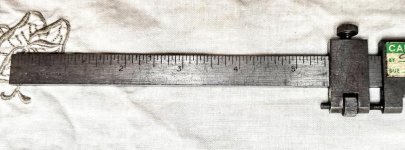

I got a $30 Helios caliper off of eBay today,,
The caliper works great,, but, it came with a half dozen accessories,,
The two black pointy things clamp to the caliper jaws,, so I could see using those.
The four stainless steel things got me stumped,, any idea what they would be good for??
( My guess is they are DIY,, the small spot welds do not look like "Helios" quality,,)
What is your guess??
The black pointy things are for measuring center to center on holes, scribing an arc or circle, measuring from one center punch mark to another, etc.
The other ones may be extensions that are clamped on to the jaws to measure inside a hole or an outside dimension where you need extended jaws to reach the feature to be measured. Someone had a specific use for those.

Is this the possible use?? View attachment 696912
Yes. That would be for an outside measurement like a brake disk. You can probably turn them around and do inside measurements like pipe, tube, etc. You can take the measurement, record or remember the reading on the caliper, remove the caliper, set it back to that reading, and measure across the tips with another caliper for inside or outside.

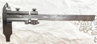

Well, I can not resist,, sometimes,,
I bought another,, this will be a basement workshop caliper,,
I got it off eBay as the second bid, $7.50,, ( I can afford that!! LOL!! )
The back is marked as a depth gauge,, in fractions of an inch ( 1/4" etc,,)
I have never seen that on a caliper,, they are normally in thousandths,, ??
