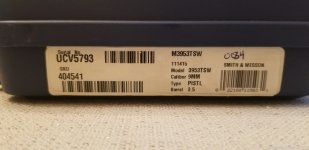

Agree on price - too high - there have been 4 3953TSW in UCU5793-UCU5897 in original SW cases LNIB on GB recently - all 404541, all 8rd, all UPC 0 22188 11503 1, all Houlton ME, 3 with same 3197 date code (UCV5883 checked by SW as 2013). Dont think any went over $600.
Wondering if the odd Product # 404541 may be tied to a unique Double Strike configuration - there have been at least 5 examples with that product code on GB in last year (4 mentioned above plus one BAW prefix Springfield, MA dated 2004 - I have one and will try to check it when I get a chance today or tomorrow.
Other Product codes observed for 3953TSW are 104540 (early = 1997-1999 7rd, No Rail, no LCI port) and 149332 (9/2008 8 rd, with Rail + LCI Port)

The SCSW lists to product codes for the 3953TSW "9Tactical."
104541 with features DAO, FS (stainless color), AA (alloy frame), SB (Black Blade front sight) , NLC (Novak Low Carry Sight), ER (Equipment Rail).
404541 noted as "DA Special." That's the product code on the box with the gun for sale. Does DA Special indicate yet another small production run of guns with special features?
One more fun fact. This might have been a LE gun as the picture of gun in the box with accessories show a total of three magazines, which is how LE guns were shipped.
