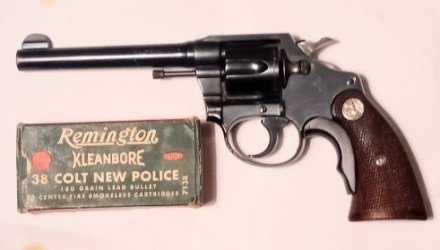

The NEI #169A bullet 2.0 grains of Bullseye pretty well duplicates the British service load, 200 grain bullet at 650 fps. I have shot it in British Service revolvers and Colt's Police Positives. I have not shot it any I-frame or any top-breaks other than the Enfield. Matt's bullets is the place to go if you don't roll your own.
650 fps is correct for a 5 inch barrel gun with typical wartime B-C gap of 0.008". My 1924 Colt Police Positive produces likewise.
You can match this in a 1-7/8" barrel Terrier assembled at min. B-C gap of pass 0.003 / hold 0.004. Mean Assembly Tolerance is pass 0.005 / hold 0.006" - which my 32-1 is.
