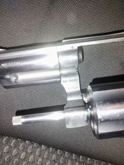

I have had my M66 ND, serial number 4K186XX, since 1975. It was a gift from my Father.
It has stainless sights, but I changed the rear sight blade to a white outline blue one. I have the original football targets it came with. It has been carried on duty, hunting and has been shot a lot. still is very accurate and looks good.
Maybe someone can give me a close estimate when it was made and if anyone is keeping a list of early 66's can add it to it.

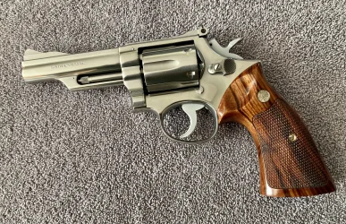

Looks like someone took some smooth targets and put wide checkering on them unless these are after market or maybe special order?

Looks like someone took some smooth targets and put wife checkering on them unless these are after market or maybe special order?
I tell people, occasionally, that they are the only K-frame Cokes in existence. Some might believe me. 😂
Yes they are smooth presentation stocks I bought from fleabus101 a few years ago. Curt Harlow reshaped them and checkered them in that style. He did his usual masterful job and they get a lot of questions at the range sometimes. The diamond not around the screw escutcheon saves me from any patent infringement problems. 😉
They look fabulous.

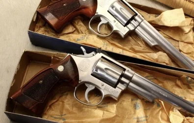

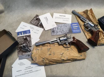

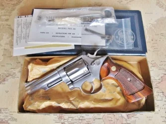

I have a sequential pair of 66-1’s, often wondered how one would wind up with a sequential numbered pair….mine are new in the box, as tempting as it is to take to the range!!
    86.8 KB
    1.1 MB
    1.1 MB

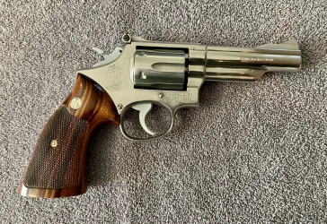

My 66 is 2K9xxxx, 1972 I believe. I shot it a lot. I carried at work for several years, shot it recreationally, mostly with factory Magnums or hand loaded equivalents. By 1980 it was getting pretty loose, spitting lead, etc. S&W overhauled it, and about the only original parts left are the frame, side plate and rear sight. When it came back from S&W in '80, it had a red ramp front and black rear sight. I think the black sight was blackened stainless, as it has an S stamped on the bottom. About the time my 66 came back from S&W, I switched to carrying an L-Frame, so the 66 has lead an easy life in the 46 years since. They are nice little revolvers in any case. By the way, those K-Frame "Cokes" are beautiful(y)
