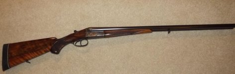

ever attach a sling to a DOUBLE BARREL
The Europeans and British like slings on double guns. Their swivels are usually mounted on the rib between the barrels. I have seen a sort of a clamp that goes over both barrels to hold a sling swivel, no idea where you might find one. I would not put one on the wood fore end of a double gun.
Almost all doubles I have ever seen had a block either silver soldered to the under rib or the block was mounted with screws. Never seen one mounted to a forend. Doubt the forend latch would hold the sling mounted on the forend wood
Many years ago I had a gunsmith put a sling mount on a Savage double for turkey hunting. It was in between the barrels an inch or two in front of the wood.
Years ago I had a sling put on a SXS shotgun that had a push button release on the forward end of the forearm. The wood in the forend was not thick enough for the swivel threads so a piece of metal (oblong washer with threaded hole)) was placed inside the forend for the swivel screw. Worked great. Larry
Swivel bases are just soft soldered onto the bottom rib. Sometimes held with two small screws (5x40 or so),,a few both.
O/U swivel is soft soldered right to the bbl itself.
For a quick sling hook up, there are slip on arrangements like 6518John linked to that slide over the bbls and down to or almost to the forend.
Some block your sight a little or a lot as they wrap around the top of the rib. More expensive ones are leather covered spring clip steel up front that slides down w/a space to clear the rib.
I'd avoid attaching to the forend wood. Pulling the wood right off of the forend iron isn't uncommon.
Alot depends on what type of forend assembly attachment mechanism you have on the gun and then how the wood is secured to the forend iron itself.
I WOULD GO THIS ROUTE, POSITIONING IT WHERE Rudi's WAS. A SMALL FIXTURE, SILVER SOLDERED IN, WILL BE UNOBTRUSIVE.....
IMHO, THE WOODEN FOREND IS TOO FRAGILE TO SUPPORT THE WEIGHT OF THE WEAPON, OVER THE LONG RUN........
