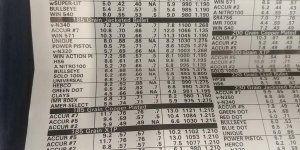

I based my initial decision on printed data, I just found what I had originally read (see image) It shows 8.0 gr as a beginning point and not to exceed 8.2.
I have already agreed to de-bullet and start over, so.......

That data sheet looks to be a bit old to me. And I would say the Unique starting load data was a misprint to me. Unique isn't so touchy that it has only a .2 grain difference between starting and max load for 45 Auto. What clued me in that it's some older data was the inclusion of Win 571 powder, which has been off the market for better than 10 years.
Perhaps "foolish" was a bit strong. My apologies. I see you used one source for load data, a Lee manual. I would suggest you get a better reloading manual; a Lyman 50th and/or a manual by the bullet manufacture of the bullets you are using. Lee isn't all "bad", but there are many other, much better manuals available. We know the Lee data is a compilation of other's testing and I'm not sure of the age of the data. Any time there is only one load listed, that is the max. charge and should be reduced 10% (and 8.0 is a bit higher than 7.4). I would suggest to any newer reloader to stick to published manual data 100%, at least for the first 10,000 rounds and after the reloader as a handle, an idea about powder charges, pressures and velocities...
Nuttin' wrong with asking, but ask/research before loading. My "Rule #1" is I pay no attention to any load data I see on any forum, any pet loads website, hear from any gun counter clerk, range rat, good intended friend or gun shop guru. I get 98% of my data from published manuals with a bit from powder/bullet manufacturers websites. Has worked well for me since I started reloading in 1969...
