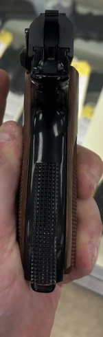

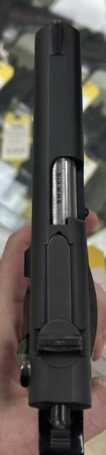

Ok, so this popped up in a local shop. It appears to be a first year production with two original mags. Condition is a 8.5-9/10 (probably a 9 after cleaning). Would this be worth more than the $679 they are asking?
Son of B. Pics are small. No dash serial # 2730 with S&W marked mags (bottom of floor plate)
Hello Mr. ARAK, nice early mod-39, with 4digits. Its not first year. Its post 1957 because it is model stamped. $679 is a fair price with 2mags. I would be in at that price, but I collect them. The early series is known as 9MM/DA
or pre-39. Buy it and shoot it.

Nice early Model marked 39.
There were several changes (improvements) implemented by the time your gun was produced, the ones that jump out the most are the long safety lever and relieved left side stock top to clear it, the other is it's long tang to eliminate slide bite when held too high with chubby hands.
There were a few other little changes as well but those are the biggies.
If you want to start a 39 collection that would make a nice beginning piece, if you are strictly looking for a shooter I would recommend looking for a 39-2 mostly for its improved extractor, there are no replacements for the older style wide extractor if it is ever broken.
Ps, the magazines appear to be correct style with the metal figure 8 follower for that era gun.

The early 39 mags had 9mm and S&W stamped on the bottom of the baseplate. They discontinued stamping them 9mm when the Model 52-A came out in 1960 as they used the same baseplates. The mags for the gun you posted should have the 2 line baseplates.
Early magazines would have had a metal follower, the plastic follower started with the Model 39-2 around serial number A200000. Is it worth $679? I think it is as Model 39's in the condition pictured are few and far between.
