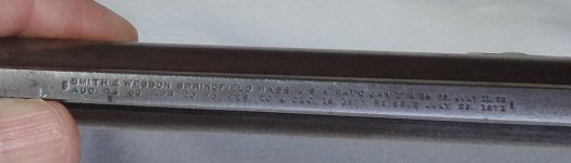

Once again, I turn to the experts. I recently acquired a new (to me) pistol at a price that seemed too good to be true for our Canadian market. I've started going over it and it has some features that are different from others that I have handled and my keeper. It's .44 Russian, it has a 6-1/2" barrel and 1-7/16" cylinder with what appears to be a brass foresight. I put it side-by-side with my keeper for comparison. Is that a target rear sight? If so, it seems odd that there's no allowance for lateral adjustment, but I've never actually seen one. It seems designed to lift up for a better sight picture, but it also seems you have to do it "just so", otherwise you trip the barrel latch. Of note, the serial on the sight doesn't match the numbers on the pistol. The cylinder and frame have matching numbers but the grip panels don't. I'm wondering if someone took a barrel and mated it to a frame. It's odd that so much nickel would remain on the frame but there's none, nor evidence there ever was, remaining on the barrel. Also new to me is the front of the pivot. You will note on the pic that the new one has a sort of divot as opposed to my keeper. The mechanics on this pistol are excellent. Half cock, single and double action, advance, timing, and indexing are all excellent and cylinder slop is almost non existent. BTW, serial on the frame is 11451 but the serial on the sight is 20840. Any input would be most appreciated.

Excellent example!
Exmilcop,
This is an Excellent example as to why we must closely examine ALL antique firearms to determine what we are looking at.
The simple reason is because all early antique firearms lacked caliber stamps on the barrel. You can actually have a "mixed" caliber gun on your hands. Which of course is NOT SAFE.
I have seen many over the years with the seller having no clue.
First and foremost you must confirm matching numbers on all parts. It's not just for evaluating the guns net worth. It's also to make sure you don't have the wrong calibers assembled together.
In this case you have a New Model 3 barrel having the last patent date of 1871 on a Double action frame.
Remember, the NM3 came in many calibers. So as an example, you could have a 38-44 barrel in front of a 44 Russian cylinder. NOT a good idea.
All large frame double action 44's had the last patent date of 1880 with the earliest production. So that's a give away when you see an 1871 patent on a double action frame.
Probably why this gun was so cheap. Since the early NM3 was not caliber stamped you CAN'T EYEBALL IT AND CALL IT A 44 RUSSIAN. YOU MUST SLUG THE BARREL AND MEASURE IT TO CONFIRM CALIBER!!!
Ok, now that we've confirmed a miss-matched assembly, parts are also worth a lot now so even with the miss-matched assembly you might have actually done really well depending upon the sales price.

Hi There,
The barrel appears to be from a New Model #3 single action based
on the patent dates on top. The "divot" is from when the extraction
was still the first type rack and pinion actuated.
Your rear sight is missing some parts.
Cheers,
Webb

Post #3 is smack dab on the money----"missing some parts". The parts it's missing is the entirety of the sight carrier---and the sight itself.
The latch for the target models started life the same as all the others. Then they milled a slot right down the middle----from one end to the other---and they milled a notch at the butt end for a place for the sight carrier to sit.
The sight carrier is one piece---with it's own tang---which fits in the new slot. This latch, as it sits, is a disaster waiting to happen. The disaster, if it hasn't happened already, is some poor soul will open/close (either/or) the barrel, at which time the latch tangs (now two where there used to be one---and are weakened accordingly) will bear against the barrel catch cam-----AND its VERY STOUT little spring. When that happens, the now two latch tangs which used to be one (AND A BUNCH STRONGER) will first bend, and then break----SNAP!!! (They will bend inwards---into the space where the sight carrier tang is supposed to be---but isn't.
The best fix for busted tangs is to be had at the hands of Chris Hirsch-----a WIZARD gunsmith-----IF he's still in business----and not off taking REALLY FINE pictures of wildlife---mostly our feathered friends. Google Chris Hirsch Gunsmith.
The other part of the fix is to come up with a complete sight carrier---good luck with that!!
IF/WHEN you come up with the sight carrier (only-----no sight stuff), I have a machinist's drawing of the sight stuff---the sight slide itself, the sight slide retainer, and the screw specs. Just for hell of it, the screw specs are: Size is #1. TPI is 72. O.A.L. is .125". Thread length is .085", and the head diameter is .105"---we're talking about TEENY-TINY stuff here---not something from your favorite automotive machine shop.
Best bet--also an unlikely one, is to come up with a beater gun carrying a good latch/sight assembly---good luck with THAT too!!

Murph, THANK YOU!!! As ever, you provide excellent information. Though I'm no novice to firearms, these old S&W's are a field all their own. I slugged the bore and it is indeed .44 so no fears on that score at least. As to value as a parts pistol, please bear in mind that your US pricing is considerably kinder than ours. I paid around $2140. USD for it. Having no idea of the US market I couldn't begin to guess the parts value. Any suggestions and input would be most appreciated.
