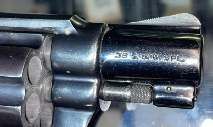

Has 2 inch barrel been replaced on this C series M&P snub-nosed ?
Dec 11, 2020
49
188
Has the 2-inch barrel been replaced on this C series M&P?
It appears to me this barrel has a NEWER bluing look to it compared to the rest
of the revolver. Also, wouldn't the front sight from 1948-51 be a half-moon instead of the ramp?
The serial number is C155xxx so about 1948-51. All serial numbers match but there is NO serial number in the flat underside of barrel.
Did a 2 inch in C series always have a serial number under the barrel in the flat? Looks like there is room.
Thanks in advance.

That is indeed a replaced barrel.
Edited to add: I was walking the dog when I typed that. Now that I'm back home and seated, I can give a more complete response.
Both of your assumptions were correct. If that barrel had been original it would have had both a serial number on the barrel flat and a half-moon front sight.
