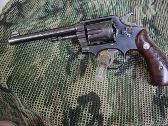

Here is a 38 M&P, 1905 1st Change (I.A.W. letter), SN: 94608 that had the barrel changed. The barrel is from a 4th change (last patent date year 1914) cut for the barrel ejector rod knob, Vs the original mushroom knob. Don't know why the barrel was changed but when the 4th change barrel was installed they must have changed the rod to fit the barrel. I'm not sure what all this has to do with the original post but I thought I would run it up the flag pole to see if any one salutes. Oddly enough, the barrel flat is number to the gun but no S&W rework marks are to be found. A very professional job.Harry Jarvis gun 008.JPG Stocks are by Harry Jarvis
