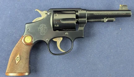

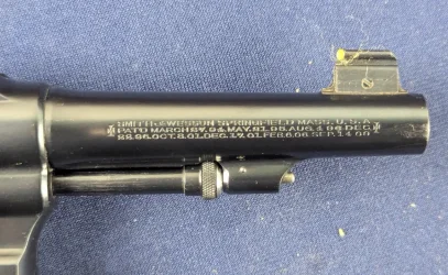

I see it now in the blue section of SCSW5. They went with a shouldered barrel where it met the frame which caused them to move the roll marks on the 4" to the side of the barrel. Not enough room between the shoulder and the front sight for all that roll marking. There is more to it, so I paraphrase.

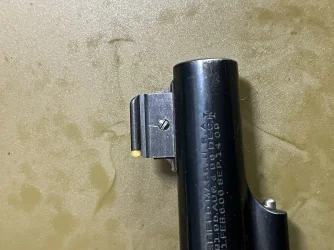

I’d remove the front sight screw and sight to see there’s a manufacturers marking.
Started to but it was fixed pretty snug. Don’t want to risk damaging it or not being able to get it back.
Thanks for the pics. One more from the muzzle would be great. :)
I don't think it is a Marbles.
It does appear that the machining on the forged front sight base is still in the white, and the rear notch enlargement is definitely white, so obviously done post Factory.
The gun is apparently a Pre 1920 gun (serial #?). I'm not sure when Dean King formed King Gunsight, but I think it was early to Mid 20s. The precise machining, the screw, and the similarity to his later "Super Police" fixed sights lead me to believe it might be early work by him. I think it is "Super Cool". ;)
