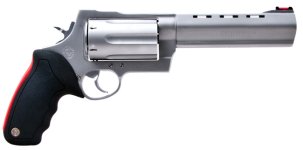

I am looking to see if anyone heard of S&W was looking to update the Governor, specifically to see if it would be competitive with the RAGING JUDGE M513 REVOLVER and I'm hoping it has a lower barrel like the CHIAPPA RHINO 6" 60DS REVOLVER. I would like to see all production revolvers take on this lower barrel look to decrease mussel flip. If anyone heard anything let me know.

I doubt Smith will add a new governor to match the Taurus you like. I doubt there’s sufficient demand.
Without regard to the merits of the barrel placement on Chiappas’ Rhino, I think it very unlikely that Smith will adopt that design.
The demand for the Chiappa has been underwhelming: not the sort of thing that would motivate Smith to invest in redesign, tooling and marketing a new revolver.
Chiappas’ patents would also get in the way.
While I would love to see Smith & Wesson attempt to compete with the Taurus Raging Judge with an X-Frame variant of the Governor chambered in .460 S&W Magnum/.410 Bore, the fact that they haven't already done so, nor has there ever been anything to suggest that they have even considered doing so makes it seem extremely unlikely that they ever will.
Frankly, the Taurus Raging Judge isn't a particularly popular model of the Judge due to its massive size/weight and relatively high cost, ergo it wouldn't be a promising venture for Smith & Wesson to develop a variant of their own.
Besides, the issue with having a Revolver chambered both in a powerful cartridge like .454 Casull with an elongated cylinder to accommodate .410 Bore shotshells is the disparity between the power of the two cartridges. Chambering a firearm in both .45 Long Colt and .410 Bore makes sense because both cartridges have similar operating pressures, (.45LC = 14,000psi / .410 Bore = 13,600psi) ergo just about any firearm chambered in .45LC is already built to withstand the pressures of .410 Bore and the only change required is to lengthen the frame/cylinder enough to accommodate the longer .410 Bore. It adds a bit of weight to the package, but in exchange adds a lot of versatility, so it's a worthwhile tradeoff.
However, .454 Casull runs at significantly higher chamber pressures than .45LC/.410 Bore (65,000psi) and therefore requires a much beefier firearm, ergo lengthening the frame/cylinder now adds a lot of mass/weight to the overall package in exchange for the ability to chamber the significantly weaker .410 Bore.
So you see, a firearm like the Judge or Governor which can fire both .45LC and .410 Bore can be used in a variety of applications (Home Defense, Vehicle Defense, Wilderness Carry, etc) because neither the .45LC nor the .410 Bore are high pressure cartridges and can therefore be produced in a relatively lightweight package. However, a firearm chambered in a more powerful cartridge like the .454 Casull or .460 S&W Magnum as well as .410 Bore is extremely heavy, thus limiting the applications in which it can practically be used.
On paper, a firearm which can chamber both a powerful handgun cartridge like .454 Casull and a shotshell like .410 Bore sounds like the ideal Wilderness Carry firearm for defense against just about anything one could reasonably expect to encounter. But in practice, the massive weight of such a firearm (the Taurus Raging Judge weighs 64oz) makes it extremely uncomfortable to carry, and at that point you're honestly probably better off carrying a 12 Gauge Shotgun instead.
Several years ago I saw a Taurus Raging Judge ULTRALITE at Academy. It had the size of the Raging Judge with a 3 inch barrel but was NOT chambered for the .454 Casull. It was chambered for the 3 inch .410 and .45 Colt and had SEVEN (7!) chambers! It weighed less than my issued 4 inch S&W Model 686-6.
