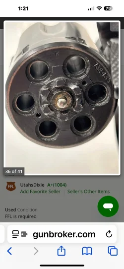

So I know some models have the serial numbers on the breach end of the cylinder, but the cylinder can be swapped out. Are the serial numbers on the frame underneath the grips? If not it would seem this to be an unserialized gun. Have any of you seen a revolver like this without out the plate with it’s serial numbers on it?
S&W places the SN on the bottom of the grip frame for revolvers.
Not sure I have ever heard of a SN on a cylinder.
The SN would be under the grips.
In addition to the butt, serial numbers used to found on the cylinder, barrel flat, yoke arm, and (usually) on the interior of the right stock panel.

I know I have seen them on the frame from time to time on certain models and of the older grips, but those aren't attached.
The other locations must be before any of the revolvers I own.
Wonder what the years are for when they stopped putting them on the other locations?

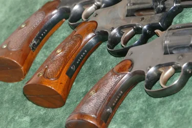

Hi Tom, do you know which models had the SN there on the gripstrap, and when it ended? I've never seen that before; love to learn new things in this field.
Todd

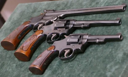

That would primarily be some pre-WWII revolvers built on the I frame, typically in .32 S&W Long but also .38 S&W (NOT .38 Special) and .22 LR. Top-break Target single shots in .22LR were also marked on the frontstrap. Guns that did not come with extended stocks from the factory were generally stamped on the bottom of the grip frame as usual.
Below from front to back are a Regulation Police in .32 Long and a so-called "Bekeart" .22/32 HFT (Heavy Frame Target) in .22LR, both built on the I frame. At the top is a 3rd Model Single Shot in .22LR.
Off the top of my head I couldn't definitively say when stamping the frontstrap ended, but it was before WWII.

The seller said these grips are oversized I guess and so the serial number is on the frame underneath the grips and they confirm this course. They don’t show a picture of that. Seems like that’s what you would do. I have seen pictures of guns completely stripped down.
So I know some models have the serial numbers on the breach end of the cylinder, but the cylinder can be swapped out. Are the serial numbers on the frame underneath the grips? If not it would seem this to be an unserialized gun. Have any of you seen a revolver like this without out the plate with its serial numbers on it?
Trust me when I say S&W doesn’t allow their revolvers to leave the factory without a stamped serial number. The formal serial number is always stamped on the bottom of the grip heel. Prior to 1950 or so, S&W stamped the serial number on a number of locations: The grip heel; the rear edge of the cylinder, the rear face of the yoke; the front face of the extractor; inside the extractor shroud; and along the hump of the hammer.
In the olden days S&W put the serial number in several places. When soft fitting ended in 1957 mostly the serial number was only on the butt of the gun. Looked for a thread on other locations, but could not find the thread I wanted. So besides the butt, serial numbers were on the cylinder, the barrel, the yoke, the extractor behind the star, and the right grip. In the days of the Triple-Lock also on the 3rd lock. So at one time up to seven locations for the serial number.

The only official SN is typically on the bottom of the butt (which is why one must be careful when converting a square to round butt or adding a lanyard ring; damaging that serial # is a big no-no. Some models have it located on the side where it is visible with the cylinder open; this considered a convenience to avoid removing the grips.
It must be on a part that cannot be removed and replaced; I think the other locations provided were part of what was called "soft fitting" to keep the parts together. Some folks will not post or show the SN for reasons they value; the lack of it in the advertisement to which you refer is not misconduct but a preference.
