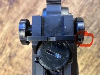

Aj thanks! Stu, There are 3 versions of the Giles site and each has a different answer. I need a close up of the LHS windage knob. It might be screwed at the center or pinned at its circumference. This is the part that needs to be taken off first! Let me know!

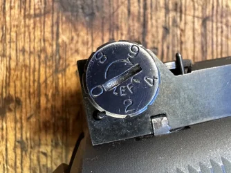

Hill536, THANKS...Photo's below. I need to take the elevation wheel off as the screw holding the rib in place is under it as seen in the photo. I found the front screw loose on this newly acquired 1958 gun. There is virtually no information available on the web. Do you have any idea of the one click point of impact change also? Seems to be very finely adjustable.
thanks,
Stu

Stu the left wheel appears to be the type three with a roll pin. You need to remove the pin. You may want to do this work inside a baggie to save the pin. It is SMALL. When done unscrew the wheel from the right side. This should free the rear sight blade that is notched in the elevation wheel. When you unscrew the elevation wheel it will lift the sight blade out.
See the illustrated pic of yours and the sights components of mine. IMG_2181.webpIMG_2182.webp

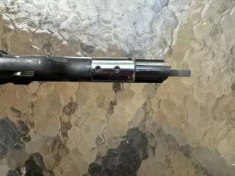

Hill536, would you have any idea of how to properly adjust the slide position/tensioner device that Giles used on some of his guns? There is room to put a feeler gauge in between the device adjusting screws and the milled portion of the slide. I think on his later versions he moved the mounting screws to the side of the dust cover. I remounted this with Loctite 360 Black.
Thanks,
Stu
