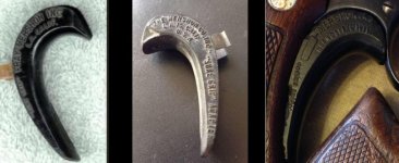

.... I've been trying to track the address changes on those, from the different locations in S. Cal. The early ones had an L.A. zone number on them. Some of us are old enough to remember "Zones." :D
Jack:
Have you figured out whether the L.A. or the Glendale address is the earlier one? And where the “Fray-Mershon” labeled ones fit in?
My oldest one, on a 1942 Colt, has Glendale. Of course there is no proof that its origin is contemporaneous with the gun, but it looks like it :)

I've always thought Glendale came later. But I don't have proof of that. Your first two are interesting. The one that just says Los Angeles is, I believe, older than the one with the Zone 15 on it (LA 15).
I think that the order of your three is:
LA
LA 15
Glendale
There are actually a couple other variations too.
I think they moved the plant to Glendale sometime in the early 1950s. I have one that came to me on a non-model-marked K-22 that was a gift from my uncle. He bought it in 1958 and put the adapter on it at that time. It says Glendale. That revolver shipped from Springfield on January 17, 1958. I have the box with an original price sticker on it - $72.00. My uncle lived in Van Nuys at the time.
The problem is indeed that the gun doesn‘t necessarily tie the adapter to a date.
The 1942 Colt has Glendale on the left side. Both my S-prefix M&P‘s, 1946 and 1947, came with Glendale adapters stamped on the right side. The only gun I bought that had an L.A. 15 adapter installed was a 1968-shipped NYPD 10-6.

That‘s in contrast to the Mershon, far right pic in the triplet I posted above. Very well-fitted too, but you can see how that was accomplished by chipping away around the margins of the adapter.
