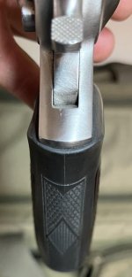

This is the grip on my GP100, which covers the backstrap and widens the "recoil" area in question but isn't as thick as the Pachmayr Presentation.

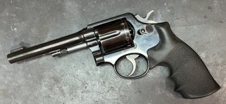

I found a K-frame Hogue and will try it on the Model 10 the next time I'm at the range

Update: Went to the range with my buddy yesterday, with my Model 10 wearing the Hogues (as shown in #16) – no bite :) My buddy also has a Model 10 with the original service stocks on them and he said he has the same problem. (He was an RCMP officer years ago and carrried a Model 10 snubbie on duty.) His 686 wears Hogues. So he'll be looking for the same for his Model 10.

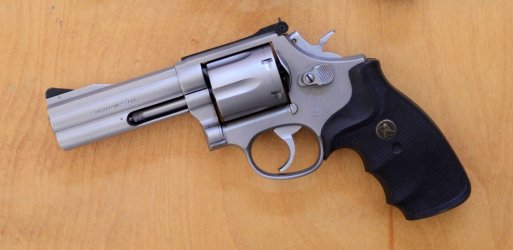

On the 625:
Took both to the range yesterday. There was some reduction in the amount of "whack" to my thumb joint and the pad showed no sign of shifting.
