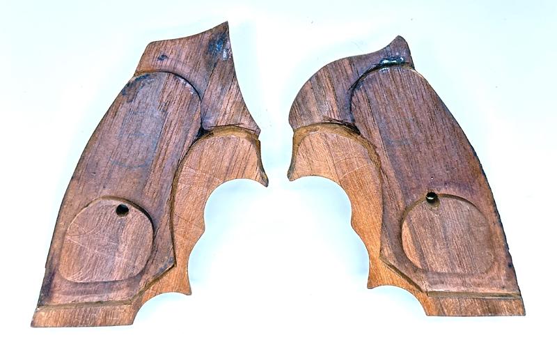

I picked up this Colt Officer Model Special for a pretty good price, mainly because I have a set of fully checkered factory target grips at home - the "Python" type but 1st style and with silver medallions.
I'm familiar with Fuzzy Farrant grips, but figured "nah, can't be" and guessed someone would have snagged the gun quick if they were authentic.
Any opinions? Definitely made by hand -
The frame grip is clipped. I guess someone could have done that and made their own.
The factory grips will cover the front of the grip frame so the modification doesn't bother me.
They are made by one of the LAPD guys. Many might say Farrant but I think maybe Joe Blackford or possibly Stark. They sure look very early. Hopefully SG-688 will be along, he knows the tell tale signs of a Blackford stock. Attached is a set I have that we think are Blackford's. Cut-frame guns aren't for everyone due to the damage, but heck I've cut two of my own.

Thanks. I haven't heard of Blackford re LAPD grips. No idea where this gun came from. Serial number puts it 1949 or 1952, depending on whether Colt website or Proofhouse is correct.
The grip pin onthe gun was removed, and I notice there's no corresponding hole in the grips. Leaving that big oval in the grip to mate up with the grip frame seems like a tad more work than keeping the pin and just drilling the grip.
I agree that the grips are by Joe Blackford who predated Farrant in making grips along with Walter Stark.
I was going to say the same thing
No one is going to give you a value so I'll jump in. The bad is hard to say exactly which maker made them and they are for a Colt, are for a cut-frame and are not an exotiuc wood like rosewood. The good is they appear older than most and are likely Stark or Blackford which are hard to come by. I would guess no more than $250 unless you find the guy with the right cut-frame Colt who thinks they are made by the grip maker he is looking for. I would keep them with the gun, to me the gun & grips together have far more value than if the gun was unaltered and had factory grips but most would not.
I hate talking value of these grips as I think especially Farrant grip asking prices are over the moon. I still think a Farrant is worth at most $200. A very few have sold for $400 + to people with the money who wanted them badly.
As noted in other comments, some other, lesser known, officers also made grips in this style. To a significant degree it's a guessing game. Later Hurst, Farrant and Hogue are much easier to differentiate as the makers found their individual styles. And even then, there are copies.
Looking now at Vtgw's grps, the top right side profile might indicate early Hurst. How's that for a curve ball? I'll have to look at his other pictures again.
They are much more comfortable than the factory target fully checkered types. Will likely hang on to them, unless or until the gun goes away.

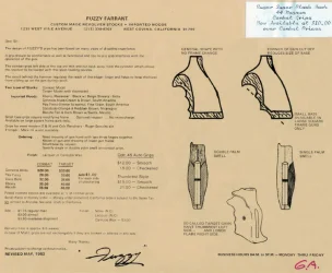

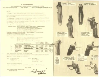

Here is a Fuzzy doc.
Yes. That one's mine. Several of Fuzzy's order forms have been posted online over the years by various members. Here's a couple.
Any catalogs or order forms from any of the others are welcome.
