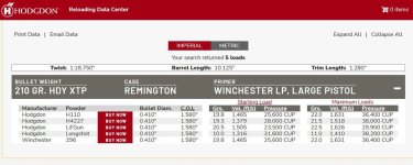

Weather and time permitting, I have a 4 5/8" Blackhawk that I may chronograph later today.

Have been shooting the .41 for a long time...the 210 XTP is probably the best bullet for big game that there is...
22-23 grains of H110 is what I use for most 210 jacketed bullets. Use a Magnum or the Winchester LP Primer with a heavy crimp...
I'll try and find the chronograph velocities...
...and just because Hornady says their load is going 1545, exactly what gun are they using...a 10" TC Contender? 210 with H110 should be mid-1400 from a 6" barrel...
Bob
Went and looked in my book...
210 Hornady with 23 grain of H110:
S&W 57 4": 1250 fps
S&W 57 6": 1350 fps
Ruger Blackhawk 4 5/8": 1355 fps
TC Contender 14": 1820 fps
Marlin 1894S 20": 1850
Would suggest starting at 21 grains and work up a 1/2 grain at a time... I went to 24 grains which showed some pressure signs in my guns and only a few feet per second velocity gain so I standardized at 23 grains.
26.0 grains of H110 with a 170 Sierra is my favorite high speed hunting round...1536 from a 5.5" Redhawk, 1875 from a 10" TC and 1980 from a 14"...
Good luck...Bob
