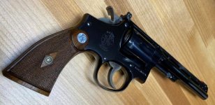

King Super Target Pics
Here are some pics finally. Special thanks to paplinker who put in a ship date request with the SWCA. Looks like it shipped with s/n 6962xx in October of 1940. Now it's time to see if it letters to King.

Cool gun, the bluing from the mid-1930s until WW II was some of the best work the factory has ever done.
Edit to add - now I see "King Cockeyed Hammer" stamped on the side of that part. :)
CONGRATS - What a beauty!!:cool: Your pre war 38 M&P Target KST is on my short list.:D If you ever tire of it, please let me know and I will give it a new home.:D:) It would go well with my pre war KST Outdoorsman Revolvers in 22 and 38/44:

Glad to see you finally got some pics up on the forum. Looks like a great gun that now requires some great target grips!
I was happy to help you get an idea when it was shipped, Now the letter hopefully will tell if King might have sold it.

Thats pretty spectacular !! Love the M&P Targets and having one with the King package would be a perfect addition to the group. Thanks for posting the pics and feel free to post another dozen or so !
Keith, if you accidentally slipped and made a set of K Frame ropers I think I would feel obligated to put them on it!

There was a large batch of 38 M&P Targets made in 1940, likely over 100 guns. I have one, #696317 that shipped in August 1940 in not near as good a condition as the OP's but original factory configuration. Another half-dozen were documented over the years and are shown below:
696252 - Oct 1940 OP's Target
696268 - Oct 1940 Target
696304 - Aug 1940 Target
696311 - Aug 1940 Target
696317 - Aug 1940 Target
696366 - Aug 1940 Target
696375 - Sep 1940 Target
