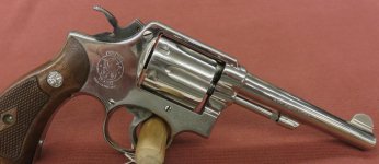

I was in my local shop and purchased this gun yesterday. It just spoke to me for some reason. Very nice action, and clean overall. But now, I'm not sure of what I really have and when it was made? Also not sure if the gun is factory nickel or not? It sure seems like it is as the finish is really nice. But, I always thought S&W never plated hammers and triggers? Please see link below for pictures of the gun. Any information would be appreciated! Hope I didn't pay too much for it!
SMITH & WESSON HAND EJECTOR PRE-MODEL 10 .38 SPL. DA/SA REVOLVER WITH 5 IN. BBL., NICKEL FINISH
You have an early post-war Military & Police model that likely shipped in 1946. As you suspect, the plated hammer and trigger make it a virtual certainty that the finish is not original. Check whether there is a letter B in front of the serial on the flat underside of the barrel. The nickel finish does look very nicely done, and while a refinish would turn off collector interest, if you like the gun, you still got a nice one for $395.

I agree with Absalom. The nickeled hammer and trigger are a dead give away. I would say that there is also a bit of evidence in the fit of the side plate.
Nonetheless , you have a fine shooter , as clean as it can be.
Is there a way to tell for certain if it is a refinish? I've owned a lot of guns in my day, and seen a lot of refinish jobs....but if this is one, whoever did it is REALLY good! Honestly, the gun doesn't look to have a box of shells through it. I have no idea why it would have been refinished if it was?
The consensus is that if there is no B, the gun left the factory nickeled. There is simply no way the factory would have nickeled hammer and trigger. But I suppose a previous owner could have decided the whole gun would look better with a uniform finish; taking out those parts and nickeling them is no big deal. Otherwise, it would be a re-nickel job on the whole gun, that is, a previously nickeled gun had its finish refreshed, and the guy got over-enthusiastic and plated everything.

When you pull the grips off, look for a stamped "N". There should also be a stamped "N" on the rear of the cylinder and the ejector star should be blued. If you find a stamp like 8.54, it went back to S&W in August 1954 for work.
Looking at the fit of the side plate, I would say it was been refinished. You can barely see the seam on a factory finished revolver. Your .38 has a really good finish, but in my opinion, it's not original.
Most collectors these days call the post WW II revolvers with the older long action a transitional model. When the short action was introduced up until the model number was stamped on the frame, these are referred to as the "pre" models. Yours is a transitional .38 Military & Police.
Model numbers were assigned by the factory in 1957 and the markings started showing up in 1958.
Enjoy. I like 5" revolvers. I have one like yours in blue.
What others have told you is correct. This is a postwar .38 Military & Police revolver. It probably shipped in October or November of 1946. The nickel plate on it is not original. The fit of the sideplate betrays this, along with the nickel on the hammer and trigger.
Having said that, I believe it is very likely this gun left the factory with a nickel finish. Other examples in that same serial range did. But this one has been refinished. Whoever did it, did a nice job, but left some tell-tale marks, as noted above. At least he didn't plate the extractor star.

There is more of a gap between the side plate and the frame than there should be. This is always a sign that the edges have been polished during a refinish. The factory would not have done this and the gap would be non-existent (barely a line between the fit points).
The nickel on the hammer and trigger would also not have been put there by the Service Department. The gun has been re-plated - although I agree with you the guy did a very good job.

Look at the fit on these two side plates:
Unaltered side plate on a M&P from 1926. Note especially the fit at the very front of the side plate.
Refinished Victory Model:
Yours isn't as bad as the Victory, but it isn't as tight as the earlier M&P.
JP@AK -
Excellent comparison. Also - note the fade in the "Made In USA" stamp just forward of the forward most side plate screw of the OP's nickeled M&P. I see some buffing fade there.
