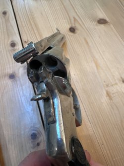

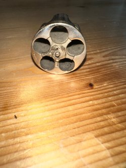

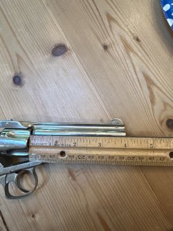

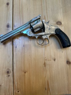

1. Top Break
2. Ser# 154xxx
3. 38 S&W (I believe) and not the special
4. 3 15/16" barrel (or 4 inch barrel)
5. Top break fixed
6. Strain screw on front of grip strap/ No Butt Swivel/ 4 screws total (one top break screw/one hammer area screw/one front grip screw (of course another screw to hold black plastic grips on as well)/one screw on henge to break cylinder area open)
1. Top Break
2. Ser# 154xxx
5. Top break fixed
Supposedly my great great grandfathers and from 1800's but someone could have gotten it wrong---all serial numbers match...only readable things are serial number and top of barrel -- " Smith & Wesson Springfield Mass USA July 11, 65 Aug 24, 69 issue"

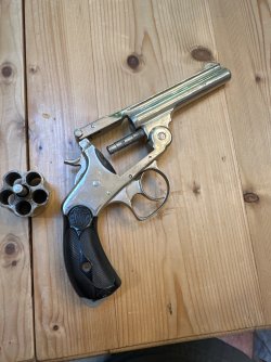

Hi There,
Welcome to the Forum!
What you have looks to be a .38 S&W DA (Double Action) 3rd model.
these were made between 1884 to 1895 (Serial No. Range: 119001 to
322700). Judging from your serial number, I would say yours was made
in late 1884 to early 1886.
Unfortunately, yours is also a very worn and heavily refinished condition.
Commercially, It would not have much value but being a piece of Family
History, it should have great value to you.
Cheers!
Webb

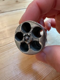

I would love to get it working again---is there anyway to repair the cylinder ---it seems to catch and doesn't allow the hammer to go all the way back and catches the trigger.?? If I remove the cylinder the hammer and trigger work fine...? Any info would be greatly appreciated.

Is there anyone who can repair or talk to about me possibly repairing...after one pull of the trigger and the hammer releasing it doesn't seem to cycle but I've never tried to shoot it---should I try to put a bullet down range? Worried the cylinder might be so old and loose that it won't align up with the barrel correctly...and can you use modern 38 s&w bullet? Or is that a no no?

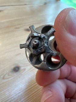

Great Family Heirloom!
The nickel finish on your antique 38TB is typical of one offered in the early 1900's to "DRESS UP YOUR OLD REVOLVER" with our bargain refinish. Major Distributors offered this type of finish to get customers in their establishments. They nickeled the entire gun at a bargain price!
The action issue is likely related to a worn or damaged ratchet. See photo.
We need to start here so if you can post a high quality photo like this one we can get started evaluating your antique revolver.

Wow,
Yeah, your antique was definitely used a lot. Heavily worn and likely bent ratchet in multiple locations.possibly even removed and replaced and/or reinstalled incorrectly. It does not fit the cylinder correctly.
What you can try is to fill the cylinder with 5 empty cases and see if that stabilizes the ratchet play. It might improve the action.
I'll post more photos later but your ratchet is very well worn and will need to be replaced. With this kind of wear(yellow arrows) it's also very likely that the hand(pawl) is bent and chipped as well. So multiple issues exist.
The ratchet was the most common part replaced on these top breaks. Primarily due to wear/abuse. It usually starts with one tooth and one chamber malfunction and only gets worse from there.
Often when I replace the ratchet with one in much better shape the problem is solved.
Murph
Wow,
Murph

Where can I get a new hand and/or a new ratchet from? Bc the timing is definitely off...
