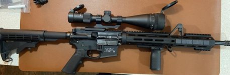

Thanks guys, sorry I should’ve include a photo. Here you go.
Also i don’t recall that the drop in hand guard locked in to the gas block, I think it only locked in to the delta ring. But I could be wrong, I’m new to the AR platform, this is my first one.
It was a fairly inexpensive one, here’s the link to it. I only paid $65 for it, and it seems well made. I know it’s not free floating, that would’ve forced me to take off the front sight and gas block.

Other than clipping into the Delta Ring, that handguard has to attach to the FSGB/hand guard cap somehow. Otherwise, it wouldn't stay very ridged. Cutting the FS isn't hard at all providing you have the proper tools and use a little finesse. But then you won't need that cut-out that your current hand guard has. Decide exactly what you want to do, how you want it, and buy the correct accessories once. You're just going to end up chasing your tail and spending money on stuff that you're just going to take back off and end up in a box of parts.

Use a high-speed cut-off saw with a thin disc to lop off the sight tower as close as you can, then use a Dremel with appropriate grit wheel(s) to clean it up. Since you're not going to remove the FSGB (I'm assuming) to do the work, you can tape off the area around it and spray paint the exposed area where you did the cutting. The cut-off FSGB is usually completely covered by the new rail so once that's installed, you'll hardly see it. Not so much if you're going to put your current rail back on.

Thanks, like I said, I may just leave it alone since it’s not even in my view. It just looks ridiculous with the long range scope on it.

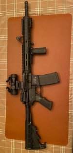

Top is a Daniel Defense M4V7.
Bottom is a Daniel Defense M4 Carbine with a Geissele Super Modular MK8 13.5" M-Lok Rail. I removed the (pinned on) FSGB on that one and cut it myself so I could install the Geissele rail. (See Pic).
You don't have to remove it to cut it. But you can do a better job spray painting it if it's off.

like I said, earlier I already found that Yankees hill flip/gas block, but I have that drop in handguard, don’t know it the folding sight is able to fold in my Vism handguard slot that the A2 sight fits into. To me, it looks like is made for an AR with the standard, short handguard that runs from the delta to the back of the gas block sight. Here is a photo of it up close. The gap is a little wider than the pick rail and about 2.5” long. Does anyone have experience with this? Would it work with my handguard?
