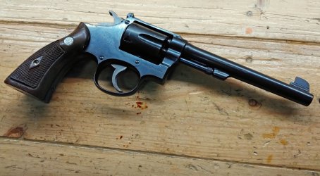

Very cool information,funny my pics make it look rough.In hand it looks to be the sandblast black magic in good condition for age.Thank you Guy and all who helped.How about a value?

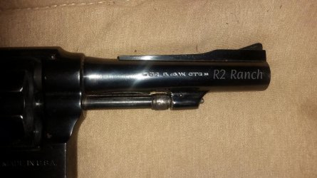

DWalt,the barrel on mine doesnt show special,just 38 s&w. 4" serial matching.

What I do not understand is why the barrel apparently lacks the normal factory-applied caliber stamp on its side. I cannot think of a good explanation unless S&W was somehow supplying such barrels to British armories. Never heard of that.
What I do not understand is why the barrel apparently lacks the normal factory-applied caliber stamp on its side . . .
Just noticed this. The OP's first post shows the barrel and it is stamped. His picture is below. I thought all guns in the
