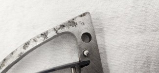

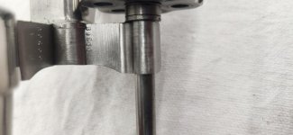

Can anyone help with this k22?
I have done some research and if what I think i have is indeed a factory nickel k22 post war it maybe considered a unicorn among collectors and very valuable. Was hoping to get a value range to help me decide if I should just use the gun or put it up in the the safe or send for sw factory letter and pass it along to a high end collector.

A factory letter will tell the tale.

The "Star" marking indicates a rework of some kind. A Nickel refinish was commonly indicated by "R-N" inside a rectangle on the butt.
Nice that whoever did the work did not plate the front sight, but left it blue>
The serial number would indicate that is a 1948 unit.
I agree that the star by the N most likely indicates that it was sent back to the factory for a finish change. That is a possibility, and I'd suggest a letter request specifically asking about the finish. Maybe the SWHF records will reveal something. Is there a date stamp on the left side of the grip frame near the toe?
Wouldn't the star almost on top of the N indicate a definite later finish change.
You might save your money on a factory letter. According to Doc44 in the link to the other K22 there's little chance that research would show a refinish.

Welcome to the Forum. We see nickeled K22s occasionally but not often done by the factory. It would be worth more to me than the average factory blue re-finished K22 but not a lot more. If it was mine I think I would get the letter and then ask for a deep dive from the Historical Foundation as correspondence or a work order for whatever was done may be available.
