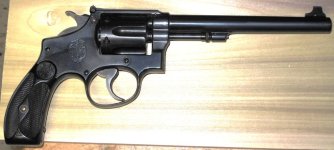

Saw this at my local gun shop and just could not leave for home without it! 6 inch barrel with strong bore, cylinder chambers are nice and clean BUT it appears to have been re-finished at some point in the past and I do think the grips are reproduction are there are no markings on the inside ( and they are just too nice condition!). I traded into it and I got a somkin deal even if it's refinish. So, I am thinking it is a first model 1905, the adjustable rear sight looks original along with the front sight. Any help would be appreciated!!

It is a very early Model of 1902 target model. Only the early revolvers (to about 1914) had the ".32 Winchester" caliber stamping on the barrel. Some collectors call such revolvers the "Winchester Model." It could have been refinished, but if so it looks like a good job. Yours is almost certainly from 1902, maybe 1903. Original hard rubber grips usually had the gun's SN scratched on the back.
It is a Model of 1902 target. The stocks are correct, if not original.
Here are some nearby serial numbers with ship dates:
8037, target sights, 5" barrel, shipped March 1904
9097, fixed sights, 5" barrel, shipped August 1903
I agree with DWalt, it appears to have been refinished but someone did an excellent job of it.
I read the serial as 6406. It appears to be upside down in the picture. Here are some known ship dates:
.32 Winchester Model 1902 serial 6388 shipped in July 1903.
.32 Winchester Model 1902 serial 6396 shipped in September 1903.
.32 Winchester Model 1902 serial 6961 shipped in November 1902.
Checkering of various parts of the gun is not uncommon for these early guns. Sometimes the front and/or back of the butt-frame are checkered along with the trigger. Question is always whether it was factory or by the owner/gunsmith? I have not found much evidence to determine either scenario and tend to think that the factory did some of this work on request. Best determining factor to look for in refinished early 1902 and 1905s is to look at the mushroom ejector knob. They were case hardened and never blued, but yours is blued. This era S&Ws had a threaded knob. Starting with the 38 Model 1905-3rd, around #146,900 & #45,201 in 32 Winchester, the rod and knob became one piece in 1909. After that date, the knobs are blued on blue guns. If you can remove the knob, drop it in rust remover and reinstall to get the appearance of the gun back to original factory appearance. A 38 example of the knob is below along with a checkered trigger.
Your stocks are factory. I can make out a faint patent date line on the bottom of the left stock, which is something you will never find on reproductions. This reads PAT'D JAN. 29, 78 in a semi-circular line. I also think I see a faint "0" on the inside of the right stock?

A very nice Model 1902 .32 Winchester Target! I cannot see anything in any of your photos that show any indication the gun has been re-finished. Even many factory re-finished S&Ws show the typical rounding of the sideplate seam and screw holes, even if slight! Those areas show as still sharp as they would when the gun was new.
As Jack (JP@AK) said, the stocks are correct to the gun for it's age. Either Hard Rubber or Circassian Walnut stocks were used on the round butt guns. If original the serial number will be found scratched into the inside surface of the right stock. Those stocks are in exceptional condition as the hard rubber gets extremely brittle with age and can break just by shooting the gun, just as MOP can do. Really they look too good to be original, and do not have the SN on the right stock. They are definitely factory, not reproductions, but may have been an early replacement. K-frame factory hard rubber stocks were still used clear until early post WWII on round butt models.

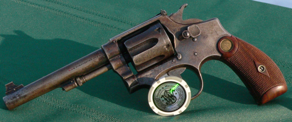

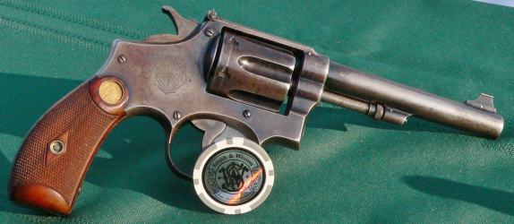

Speaking of early .32-20 target models, here is one I bought back in 2005. It has the 5" barrel. Early 5" target models are extremely scarce, perhaps even rare.
This one came to me with the later stocks shown, which are beautiful, even though not correct. They are currently stored with the gun, but it now wears correct hard rubber. The letter indicates that it shipped to Philip Bekeart in San Francisco on March 15, 1904.
Lots of honest wear on this one, but it is dearly loved. Shoots like a dream!
I will reiterate that the most obvious telltale sign of a refinish on 1902s is to look at the mushroom shaped ejector rod knob. They were a separate piece, case hardened, but not blued like the Model 1905s. The OP's ejector rod knob looks blued to me.
