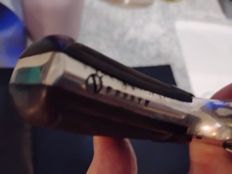

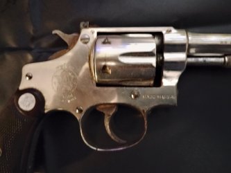

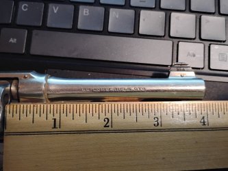

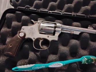

S&W 22lr. Nickel plated, hand ejector, 5 screw, barrel length 3 3/4".
# on front grip strap 533374 or 75
# on yolk 44223

Thanks for the feedback, Jack. It is definitely 3 3/4". measured from the front of the cylinder.
the last time it was fired was in the early 70's. I shot it some right before I went into the Navy.

BPHoo,
Nice taste in Revolvers Your Grandfather has...Hopefully he's still with you!!
That aside...I thought I'd bring to your attention something a couple of the other guys failed to make mention of that sets Your Grandfather's Pre-War .22/32 Kit-Gun apart from most others you'll see!!
That being...Even though the Photos are a bit grainy...I have good reason to believe the Nickel Finish is "Original" to the Revolver!! Just asking, but have you by chance removed the Stock Panels to see if there are any Rework Dates stamped on the Left Lower Inside Grip Frame indicating it was returned to the Factory for work of some sort...You're looking for something like this (5.45) or the like stamped there!!
Reason I ask is I don't see a Rework Star stamped somewhere near the Ser. No. on the Frt. Strap of the Grip Frame which is where you'd generally find an indication it had been returned for some sort of Service Work...Although not specifically to be refinished!!
Now the reason why Your Revolver got my blood up a bit as being something special...In the 50+ yrs. I've been collecting S&W Revolvers...I've only ever crossed paths with (1)...Yes (1) of these Pre-War .22/32 Kit-Guns that "Factory Letter" as having a Nickel Finish....I'd consider them to be Very,Very Scarce to Rare as far as I'm concerned!!

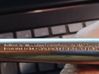

There is one thing I'd appreciate you doing if possible...Could you take another Photo of the Top of the Barrel being that in the one you posted something is more than a little distorted to read the Address & Pat.Dates...Appreciate it!!

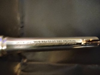

Thanks Masterpiece, the top of the barrel says.
Smith and Wesson, Springfield Mass,U.S.A.
Patented Dec.17,01,Feb 6,06,SEP.15,09.
My grandfather passed in the late 60's (I am 70 years old). My grandfather was nothing if not careful with his money. I would say everything is original. He kept it clean and its been in a safe since the early 70's. No stars🙂

First of all...Sorry to hear Your Grandfather passed...He left you with a Pretty Scarce Nickel Finish Pre-War .22/32 Kit Gun though!!
Also...You noting "No Stars"...Is that you found nothing where I noted you should look for Service Dates on the Left Side of the Inner Grip Frame...Correct?? Also...Thanks for posting another Photo of the Barrel Address as something must have went wrong when you took the 1st one you posted...Kind of looked like the Top Section of the Barrel Address had been scraped across something!!
Now as to everything being Original...The Sheard Ivory Bead Frt. Sight Blade isn't correct noted by how much hangs over the Sight Boss...Both Fore & Aft!!
As to which Frt. Sight Blade would be correct...More often than not these Pre-War Kit-Guns shipped with either a U.S.R.A Pocket Revolver Sight Blade or a Plain Patridge Blade...Generally I would consider either one could be Correct!!
As to the missing Rear Sight Blade...Not uncommon to find them either missing because the Adj. Screws came loose or broken off as they were pretty fragile & prone to breakage!! If you're handy at fabricating...They're fairly easy to make!! You could also post a WTB Ad in the Forum Classifieds here to see if anyone may have both of the Sight Blades you need to make it completely Correct!!
I also believe with a little TLC some of that poor storage corrosion can be made much less noticeable...Be careful though as you don't want to use anything too coarse to clean it...Fine Brass Wool with a little Oil should take care of the bulk of it...Followed by a Good coat of Wax to keep it from reoccurring!!
Anyway...Enjoy it as I'm sure you will...Especially now that you know it's even more special than just being handed down from Your Grandfather!!

Isn't anyone gonna bring up the disparity in barrel lengths?
Merle,
Actually having owned more than a few Pre-War .22/32 Kit-guns over the years...One with a Barrel Length slightly more or less than what's generally noted is not that far out of the norm or I would have made note of it in one of my Posts!!
Truthfully I can't recall any I'd acquired having an "Exact" 4'' Length...I'm sure the bulk of them are, but with S&W published Barrel Lengths were never an exacting science with any of the Early S&W's I owned over the years!!
Merle,
Ok, thanks for that info.
As Masterpiece posted, barrel lengths are nominal, most often on the short side. 3 3/4” is the most extreme variation in my experience.
A photo of the barrel muzzle would be helpful. Occasionally due to dropping they can be dented and repaired, shortening the barrel a little. Another clue is a dented, broken or missing rear sight blade.

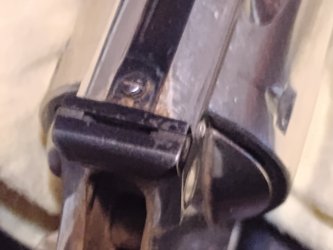

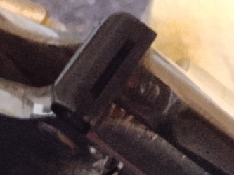

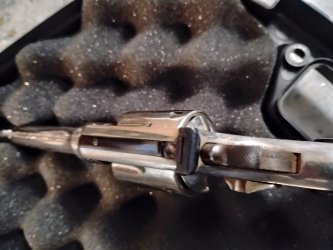

Thanks for responding. I remeasured and my mistake the barrel is 4". The rear sight blade is missing but I don't see any damage.
The response here has been amazing, I have learned so much. My initial reason for asking was to find how to find an original replacement for the rear sight blade.

Thanks for rechecking the Barrel Length...That's more like it!!
As to the missing Rear Sight Blade...Being I can't see them in the Photos...Are both the Windage Adj.Screws still there?? Reason I ask...If one is missing...The Sight Blade likely slid out & was lost since you saw no damage otherwise!!
Sorry to say I no longer have any of mine left to show you, but possibly someone here could remove one from theirs to show you what you're looking for!! It's a big ask, but I think it's worth a try asking or even placing a WTB Ad in the Classifieds!!
