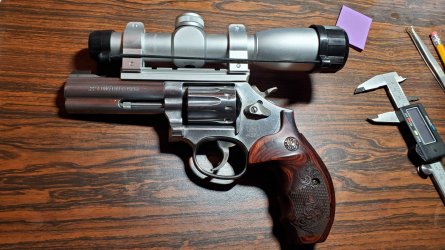

Hmmm, I also have a 686-1 and a 617-6. Got the 617 2 years ago and have never had casings stick in the cylinder. Accuracy is incredible with the scope. Bet my son I could put a bullet through the center hole of a cd disc at 20 yds without nicking the plastic. I put 2 side by side. It was great. Perhaps the rounds you shot were high power!?617-6.jpg

Hmmm, I also have a 686-1 and a 617-6. Got the 617 2 years ago and have never had casings stick in the cylinder. Accuracy is incredible with the scope. Bet my son I could put a bullet through the center hole of a cd disc at 20 yds without nicking the plastic. I put 2 side by side. It was great. Perhaps the rounds you shot were high power!?View attachment 779976
