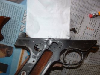

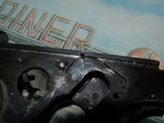

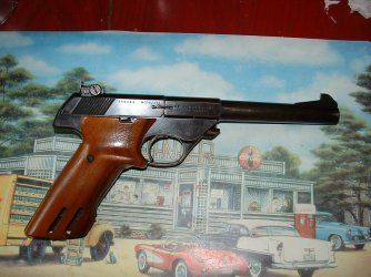

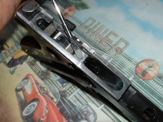

Super thanks on the HS chart as I have never been able to figure out where, when, and differences on the various models. All of the advice given is right on, particularly the part about only shooting standard velocity and changing out the main spring every 10k rounds. My favorite pistol was(is) a model 102 which I have had since maybe the mid 60's. I had fired 30-50k rounds through it when I found the new to me model 102 frame crack. I sent it off to a very well SA gunsmith who could weld anything-Unfortunately the cracks returned and the gun was retired.
I now have an model 103 as well as a grip mount red dot SW41 which weighs a ton. They both shoot far better than I can, but the HS remains my favorite.
I noted the model 102 was made only 1958-1960, probably because of the frame defect.

The 102 design series was the worst design series for cracks. The 103 frame had changes to address cracking but the changes did not eliminate them.

There is a lot of misconception about frame cracks and standard velocity. The ammunition of choice to help with frame cracks is 1080 fps with a 40 grain bullet. All frames won't crfand and some have with the proper ammunition and fresh driving springs. There are a lot of factors, most of which we have no control over.

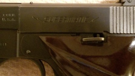

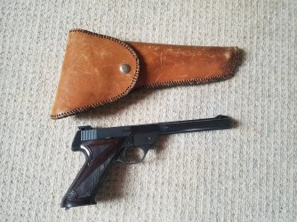

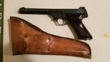

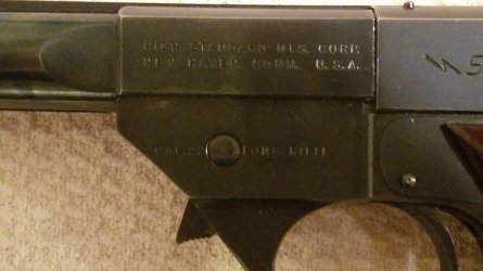

I have one, it was my Dads...but I know nothing about it. Mr. Stimson, not the best of quality...but are these pics enough for you to identify it?
