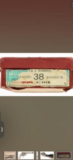

OK, here's a photo. Life got in the way last Friday and the bummer outcome caused the delay. Here's one of several stamps that have been seen on these boxes. They are not serial numbers, but I ask, 'What is the meaning'? I have a few more boxes with the numbers like these, but they have different numbers on different boxes with different descriptions for the contents.

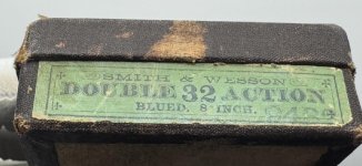

I believe that is a 1880s box with maybe a serial number stamped on the label before they started writing the number on the box bottom?? I don't think it would be an inventory number from a distributor or gun shop since it would be very unusual to find two boxes of different caliber using the same stampings. No references to these numbers have ever been found in the factory records, plus log books only used serial numbers to identify their boxed guns in inventory. Here is another end label box from a member here with the same stamp style used. I think it is 9482, which would indicate a 32 DA, 2nd Model timeframe.

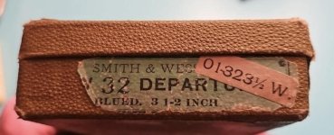

"I think it is 9482, which would indicate a 32 DA, 2nd Model timeframe." Unfortunately, the 8", .32 DA barrel didn't become available until the 4th Model along with the 10" and was dropped by the 5th Model. I'm pleased to see the first label "01-3231/2 W." in shown50's lineup. The 'W' appears on a box that I have: "99231 2W." Shown50's inventory idea follows the label: One, .32, with a 3 1/2" barrel. The inventory theory falls flat with my label. The only things that are similar is the 'W', blue finish and, if the 2 before the W is moved left, the last digits are 312.

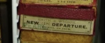

Photos depict 3 Different Distributor catalogs.
Notice 3 different catalog numbers for each gun photo'd?
Actually kinda neat because once you cross reference the Distributor catalog number to the gun box you'll know which Distributor sold that gun.

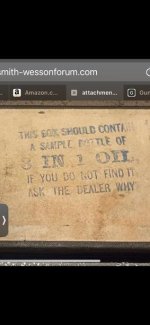

For interest, I think the $6.00 .32 from 1916 is neat with the mostly legible writing on the bottom. And I threw in the Smokeless disclaimer for giggles.
