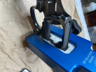

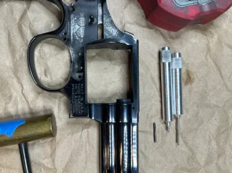

After the pin was out, the MGW barrel taker offer was attached and the barrel magically fell off.

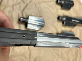

With the barrel off, the next step was to figure out what stainless barrel should be used. I can (and have) fit barrels to frames but it's sooooo much easier and faster to just walk over to the rack, grab a few barrels, and see which one fits. Yes, there's a comma in the price tag of a rack of barrels, but how much is your time worth?

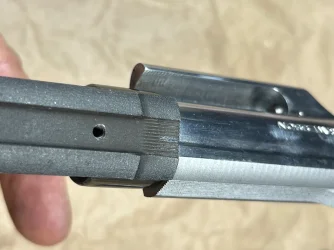

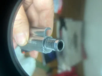

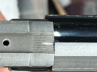

My method of barrel matching starts with threading the original barrel on until it's hand snug and making a reference mark on the frame with a pencil.

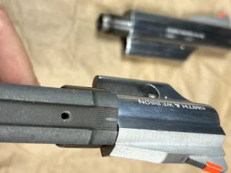

If the replacement barrel matches up with the mark it will clock properly with no fitting.
The first one did not, but was close.
The second one was better but still not quite there.
The third one wasn't even close.
Number 4 matched up perfectly.
That 4th one was a snubby barrel and I still had some 4" barrels to try. #5 matched up as well…
