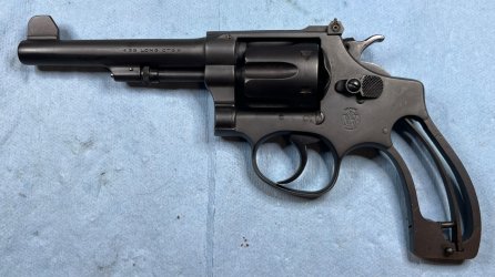

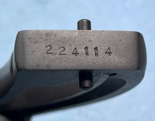

There were a couple of choices, but this one looked like it had the most potential. If I've decoded the serial numbers correctly, it's a .32 Hand Ejector Model of 1903 Fifth Change, with a barrel and cylinder that have been swapped in from an earlier gun in the same series. The front sight is a custom made piece to match the added on adjustable rear sight, and the whole thing (including the hammer and trigger) seems to have been parkerized.
The rear sight appears to be from a Kit Gun....no clue who put it there, but other than the overhang at the front it seems to have been done well.
The timing was good all the way around but the action had a hitch in it and the trigger return was mushy. We'll find out what that is when we open it up......

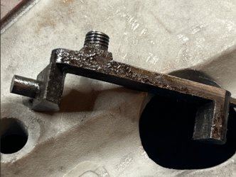

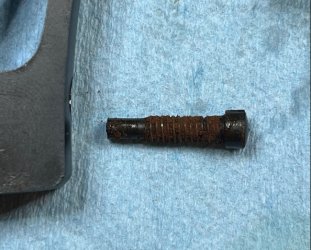

The two week soak in Ed's Red didn't bother the parkerizing at all. If anything, it improved it by deepening the color. The major advancement was that the soak allowed the strain screw to be removed. It still required some strength but it came out. Not difficult to see why it didn't want to come out. I've seen this before on a home-parkerized M1 that wasn't fully neutralized before assembly.

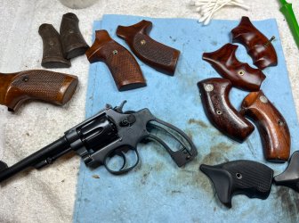

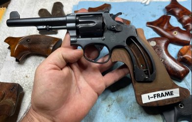

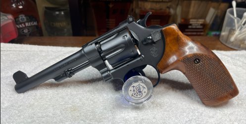

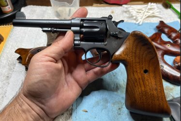

The other challenge was finding a set of stocks that would fit a round butt I-frame. I had a few choices available for J-frames, but the only I-frame stocks I had were a torn up pair for a Regulation Police and two sets of absolutely gigantic full size target stocks that had been re-inletted for I-frames. After seeing how they look on a gun I'm never going to use them, so if anyone needs these things drop me a line....

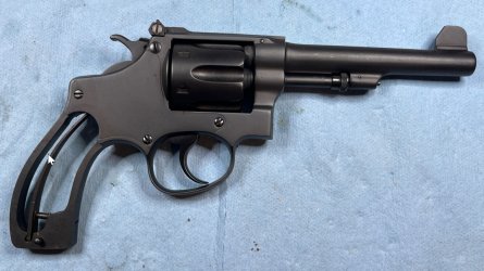

In the end, what worked best was a set of Herrett Shooting Star stocks intended for a J-frame. The pseudo round-to-square conversion that left the backstrap partially exposed and then brought it inside the wood fit perfectly, and the enclosed bottom hides the little bit of gap from the shorter I-frame. This picture really shows how the Ed's Red "softened" the grainy parkerizing texture.

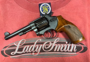

And what does the HomeSmith get for his lady as an anniversary present? A used t-shirt from Ebay of course....what else? :sneaky:
