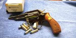

A neat concept - I'm stuck with making do with this M12 4" RB. c.1974.
Great shooter and you hardly know you're carrying it.....
