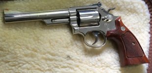

Bought my nickel plated Model 19-5 new in 1981. It still looks great. Poor storage and mistreatment will hurt anything.
