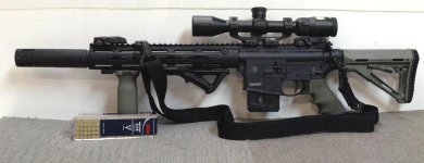

I purchased the following from kinetiTech;
"Ported & Slotted Muzzle Brake Style Barrel Shroud
S&W AR 15 / 22 6' Long - "
I Replaced the factory rail with a new Troy 11" alpha Battlerail (which uses a standard AR barrel nut) and had to cut 1/3/4 inches off the back end. I then machine the Back cap to fit into the rail by 3/8 of a inch. to get the following look.
I'm please with the outcome.
