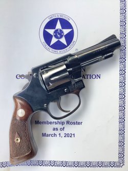

This is my 32 Regulation Police model of 1953 New I frame 4 screw that left the factory in April 1956. When the 4th side plate screw was deleted, soon after mine was shipped, it became what we call the “Pre model 31”. Except for the square frame, it is identical to the 32 Hand Ejector series we are discussing.

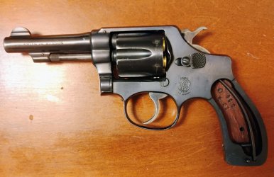

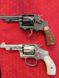

This is my post war 32 HE no model number. I do not know what kind of hammer block it has. I really like this model. My wife claimed it after she shot it! The only difference I can tell is the knob on the extractor rod. And the really nice grips are serial numbered to the gun. I'm currently trying to find another one like this so I can have one. It and my 32 caliber pimp gun are pictured below.

Thank you so much for this explanation. Now I know I don't have a pre model, I have a transitional model.
You’re welcome. Your Transitional has pre war features that not all of them have:
Pre war ‘double pinched’ cyl release thumbpiece (like your nickel pre war),
flush mounted flat silver grip medallions,
and sharp cornered checkering borders.
You can easily see the post war hammer block safety by cocking the hammer slowly while looking in the hammer channel for the safety bar lowering, and rising as you let the hammer down.
Occasionally but rarely we see a post war shipped I Frame without the post war safety. They may sometimes have the pre war barrel shaped extractor rod knob.
I call these I Frames pre war-post war models. And they aren’t necessarily the earliest guns shipped after the war!
