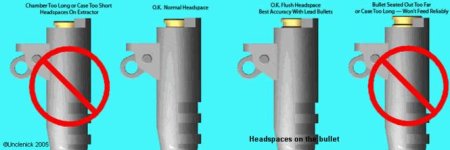

Look up the Plunk Test and try it. I never crimp my semi-auto reloads I just remove the flare at the case mouth with a taper crimp die (FWIW, in my opinion a Lee FCD is unnecessary. Adjust the dies properly, don't over crimp, and you won't need one)...
    21.2 KB
