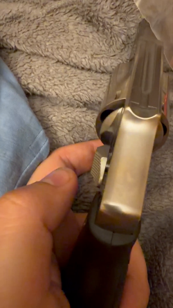

I just bought a s&w 640 , and I like it , just have question.
This is model 640-3 , so I was wondering is this normal
You all can see wigle in the cilynder relese button
Pard my english , i am from Montenehro
IMG_0652.mp4
I have tryed to tighten it some more , and damaged a scree a bit , still gap and wiggle
Anybody , is this normal or not , is this a defect?
If its defect , can it be fixed?
To me, it sounds like the screw is too long. I would take a file to the end of the screw to shorten the threaded section. Two or three passes and put it back together. If it still wiggles, two more passes with the file. Easy does it. Very hard to add to the length!
Kevin
It's normal. I just checked 15 of mine of various models. They all have some play/wiggle. It's normal because that's the way parts are fitted. If it was so tight there was no play then it would bind.
Don't worry about it. That is perfectly normal. The screw just holds the thumb piece to the stud. It's not there to tighten anything on the internal parts.
I have overthigten my screw , so i damaged it a bit
Can i buy a new screw?
Is there a web site to order a new screw?
Its not a screw , but is that normal or what?
And can i buy parts for my smith
Kevin
If you do that the thumbpiece will begin to rub on the frame causing damage to the finish.

It does look like the button has too much of a gap between it and the frame. Maybe the screw is just a little too long?
I must say though, if you got a new S&W revolver and that is the only problem it has, consider yourself lucky.
Ok , so is this defect or should i use revolver , or this is normal or what?
