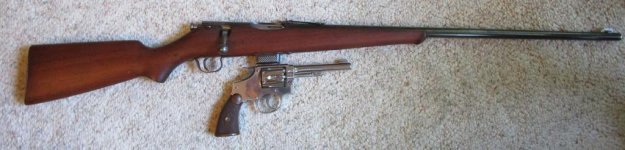

Watch out toad67, cause now you need a companion rifle to go with your 32-20, like this Savage 23C. Some people like the Winchester.
