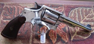

Below is mine s/n 105093 shipped October 1921 per Roy. SCSW 4th shows s/n 65701 to 144684 as being 4th change which mine clearly is.
So the Op's at s/n 655xx would be the last of the 3rd change by serial number. SCSW also shows that heat treating of the cylinder didn't start until serial no. 81287. Is the heat treating or lack thereof a big deal if shooting modern "cowboy action" factory loads? I don't reload like the OP and others on this Forum but I do use HSM Cowboy Action factory ammo which is 115 gr LFN in new Starline Brass and it seems to function fine in my old 32-20.

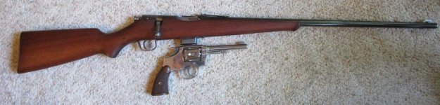

Wally, see if you can get some pictures of the old war horse posted. As you can see, many of those old 32-20's saw a lot of use over the many decades. Finding one in high condition can be a challange. Finding one in good shooting condition can be pretty easy.
S&W with a Savage 23C (32-20) companion.
