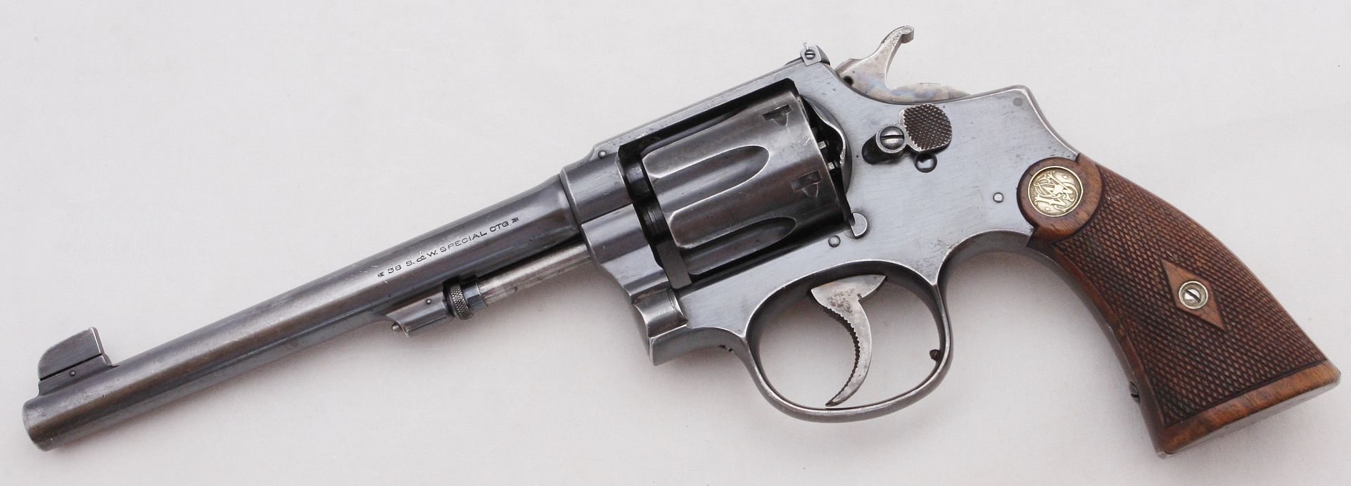

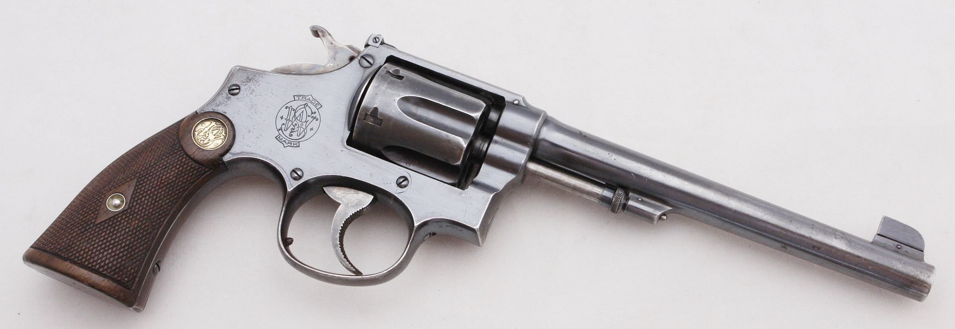

Neither of my two 1905 3rd Change Targets are nearly as nice as yours, but both of them came to me with 6.5" and gold medallioned grips:
154998 (shipped Aug 1910). The 6.5" barrel appears to be a replacement as it is numbered 165183. This well-used target gun also had some other work done, including a checkered trigger and a trigger stop mounted in the rear of trigger guard.:)
158135 (shipped Oct 1910).
Thanks for sharing the great pics of your beauty and once again, congrats!

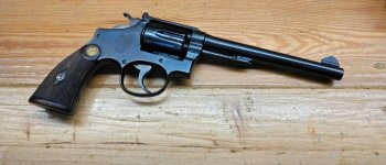

Oh, not to forget my 1910-1911 targets. First is 150057 and second is 154974, shipped 1910 and 1911 respectively.
