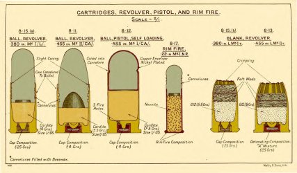

Actually it is called .380/200 I think, if loaded with a 200 grain bullet. Dimensionally the same as .38 S&W. I think .38 Special uses a .357 diameter bullet. .38 S&W is nominally .361.

The .38 S&W cartridge is a very early American cartridge design, long preceding the .38 S&W Special. It has a slightly greater case diameter than the .38 S&W Special, and will nearly always not fit into an unaltered .38 S&W Special chamber. It is most definitely NOT a shorter version of the .38 S&W Special. Likewise, a .38 S&W Special cartridge is too long to fit into an unaltered .38 S&W chamber.. It is not unusual to find some .38 S&W revolvers that have been later rechambered to allow .38 S&W Special cartridges to be used in them. To the best of my knowledge, there has never been a cartridge called a .38 S&W Long. However there are cartridges called the .38 Long Colt and the .38 Short Colt. Both are dimensionally identical to the .38 S&W Special cartridge except for having shorter case lengths. Both can be used in any revolver chambered for the longer .38 S&W Special cartridge. There was never a cartridge which was officially designated as the .38/200. The similar British cartridge was designated as either the .380 Revolver Mark 1, which used a 200 grain lead bullet, or the later .380 Revolver Mark 2, which used a 178 grain jacketed bullet. Both are dimensionally identical to, and interchangeable with, the American .38 S&W cartridge. It is entirely possible, but would be unusual, that your revolver was originally made in .38 S&W Special, and was later rechambered to accept .38 S&W/.380 Revolver cartridges. If a .38 S&W cartridge can easily be chambered in your revolver, it then becomes highly likely that is what was done. The British were known to have performed that .38 Special to .380 conversion early in WWII. It would have been about a five minute job. You really need to obtain a .38 S&W cartridge to find out for sure.

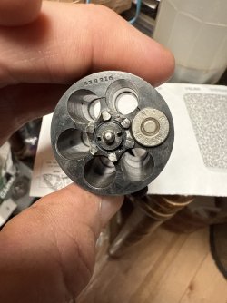

I'm guessing that this revolver has had the chambers altered to accept the .38 S&W cartridge.

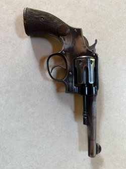

Please post a picture of the cylinder, taken from the rear, so that we can see the inside of the chambers. Look for two "rings" inside.
Two rings inside the cylinder. 38 S&W round fits perfectly.

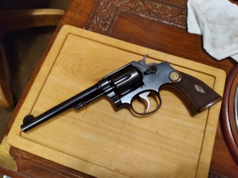

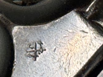

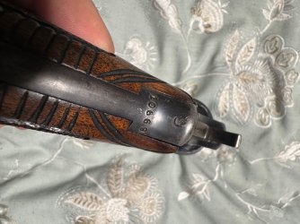

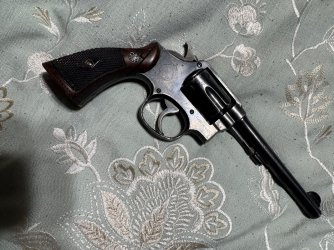

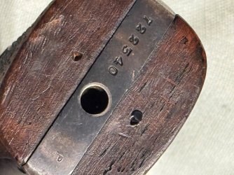

I picked up what I believe to be a Model 1905 38 M&P , 4th change. Ser # 439XXX. Gun was not in good shape outside and I paid 125.00, figured it would be a project this winter for a truck gun.
Started to get the rust off and noticed two stamps I can't find any information on. I appreciate any info people may be able to provide.

Mystery gun for sure. Did she come with stocks ? Smooth or checked?
Looks like she's all there and ready to go.
Ammo? I'm thinking, ALL of the above!
Lastly is the Butt drilled for a lanyard?
380 MK II sounds British to me. Is the gun .38 S&W or is it .38 S&W Special?
I'm thinking if .38 S&W you may have a British Service Revolver. A lot of those guns wound up in police service in Europe after WWII. The other mark might be German or Austrian. Something to do with where it was used after the war. If the serial number is 439216 I am probably wrong.

Late S&W 10 for US NAVY where chambered fo '39 S&W Special ctg but are really fragile guns and often broks barrel
Postwar many european armourer modify cilinder to accomodate 38 Special cartridge, often without termal treatment. Tehe are expecially dangerous weapons.

Prior to Lend Lease and the U.S. entry into the war, the British purchasing commission was buying up whatever guns they could find in the USA including dealer stock for their war effort. Simple enough to ream the chambers of .38 Special revolvers to accept the .380 military cartridge and put them into military service. Yours could very well have been one of those which was given to the Austrian civil police by the British during the postwar occupation period.
I'm super jealous! This was used by the occupying forces post WW2 then passed on to Austria.
The Brits had 38 Special Pre-Victory revolvers that they ordered direct prior to our involvement in WW2. These WILL NOT be marked U.S. Property and WILL NOT have the V prefix. After the 38/200 Victory models arrived these 38 Specials were handed off to less embattled regions of the Empire. The barrel should read "38 S&W Special CTG"
These are noted in The Smith & Wesson Catalogue under 1905 4th change. (4th edition p163) Yours fits the SN range. I also confirmed the British purchase through Ian Skinnerton, author of "The Broad Arrow." He is a British firearms historian and a good friend.

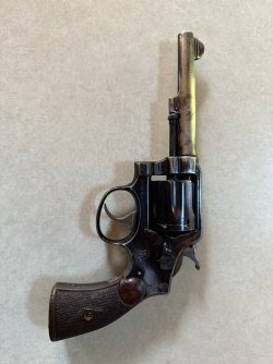

Here's some pics of my South African.

What I believe you have... After WWII Austria was divided into 4 sectors.
Under British, French, Russian and US authority.
The British & US rather quickly realized the Austrian Gendarmerie which had been disarmed, needed re-arming.
Under Denazification, the Allied initiative to re-install former Police.
The British supplied 303 Enfield's and revolvers such as yours.
Note: the issue MK #3* Enfields
Austrian Gendarmerie in the British Occupied Sector, early 1950s. Note: the issue MK #3* Enfields
