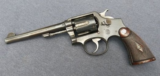

Mine has SN is 528XXX - my S&W letter says it was shipped DEC 5, 1925, so yours prior to that date most likely. (Also, letter says it shipped with silver medallions on grips, which it still wears.)

I have never read or heard of a 1920's M&P with medallions on the grips. Now I have to go down that rabbit hole LOL my 2 from 1926 in 1927. Do not have medallions, or have I ever seen one from the 20s with medallions, very interesting.

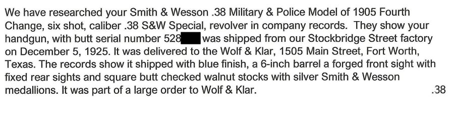

Exerpt from letter attached.
