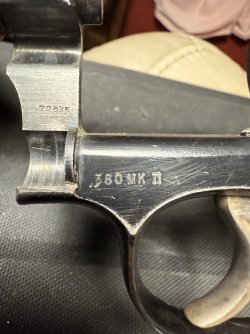

The 38 S&W cartridge has a slightly larger diameter than the 38 Special. A 38 S&W will not normally chamber in a 38 Special cylinder.
38MkIIz vas the cartridge designed from Col. Boys for Enfield N°2 pistol in 1930 and is a "dragster" S&W 38 with 200 gr ball and heavy load of "neonite", In I WW British service used ,455 pistols like Webley Mk VI, Colt 1909 and S&W triple lock,380 MK II sounds British to me. Is the gun .38 S&W or is it .38 S&W Special?
I'm thinking if .38 S&W you may have a British Service Revolver. A lot of those guns wound up in police service in Europe after WWII. The other mark might be German or Austrian. Something to do with where it was used after the war. If the serial number is 439216 I am probably wrong.
Yes, you are mistaken . . . .I'm going to do some research but thought the 38 S&W was just a shorter version of the 38 S&W Special. Am I mistaken? . . . . .
The barrel is marked 38 S&W Special.CTG as you described. It's also not marked US Property.I'm super jealous! This was used by the occupying forces post WW2 then passed on to Austria.
The Brits had 38 Special Pre-Victory revolvers that they ordered direct prior to our involvement in WW2. These WILL NOT be marked U.S. Property and WILL NOT have the V prefix. After the 38/200 Victory models arrived these 38 Specials were handed off to less embattled regions of the Empire. The barrel should read "38 S&W Special CTG"
These are noted in The Smith & Wesson Catalogue under 1905 4th change. (4th edition p163) Yours fits the SN range. I also confirmed the British purchase through Ian Skinnerton, author of "The Broad Arrow." He is a British firearms historian and a good friend.
I collect guns of the British Empire. You have a beautiful revolver! I wish I had one!

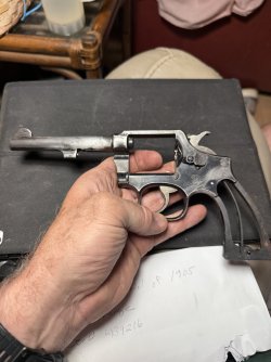

I picked up what I believe to be a Model 1905 38 M&P , 4th change. Ser # 439XXX. Gun was not in good shape outside and I paid 125.00, figured it would be a project this winter for a truck gun.

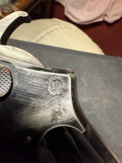

Started to get the rust off and noticed two stamps I can't find any information on. I appreciate any info people may be able to provide.

Of you find the markings CB on the gun it does mean that the German gunsmitj Carl Bernhard has converted the gun to . 38 Special. This usually happened to guns having the .38 S&W Calibra with the shorter case. The .38 S&W is a Little thicker which expandiert the 38 Special cases so that they are a little more resistent when reloading during the sizing process. This All might not be relevant to your gun, but maybe you find one some day. For the rest it is correct that the allied forces gave the revolvers to the German or Austrian police after WW II. Excellent information can be found in The fine book of Charles Pate " Handguns of WW II. Enjoy collecting these oldies!I picked up what I believe to be a Model 1905 38 M&P , 4th change. Ser # 439XXX. Gun was not in good shape outside and I paid 125.00, figured it would be a project this winter for a truck gun.

Mechanically, the gun is like new.. cosmetically the gun had some pretty bad rust areas on it but no pitting. I may have screwed up by cleaning up the rust but something had to be done or pitting was just around the corner.
Being a history buff at heart, these old guns fascinate me and I wish they could talk.
Since I only paid 125.00 for it I'm going to send off for a letter just because I want to know.

The significance of Mark 2z or Mark IIz is that the z denotes the use of nitrocellulose granular powder propellant, sort of like Bullseye, etc. Lack of the z indicates Cordite was used. The cartridge is the same, only the propellant type is different. There were numerous types and varieties of Cordite used in British ammunition through WWII. I never understood why the British were so married to Cordite instead of using nitrocellulose granular powders like the rest of the world..380 MkII was the designation of the FMJ round of the issue ammo until late in 1944 or early '45.
The designation of that FMJ round was changed to .380 MkIIz & sometimes headstamped as .380 2z at that time.
The Austrian Police mark looks like that applied to the mountain of M&P revolvers issued/given post-WW2 to them for Police and Security work.
