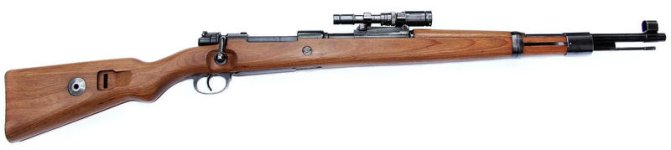

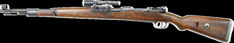

WWII German ZF-41
Thanks to S&WCHAD for posting the link to the earlier thread.
The scout rifle concept is of debatable utility, especially within the narrow parameters described by Jeff Cooper.
Furthermore, it wasn’t even his original concept!!
The Germans researched, developed, and fielded under combat conditions the same type of rifle during the second half of WWII.
Known as the ZF-41, it began with a long eye relief scope mounted on a detachable mount fitted to select Mauser K-98 rifles. The ZF-41 program later expanded to include the semiauto G-41 rifle, and a short carbine.
Specified as a designated marksman rifle, it was intended to fulfill a different role than a true sniper rifle.
The field results were mixed. Many of these rifles were abandoned in favor of captured scoped mounted Moisin-Nagant rifles.
I believe American Rifleman covered this in an article entitled, “The Original Scout Rifle?” (Published Dec. 2006)
The K98k Zf 41—The First Scout Rifle? | An Official Journal Of The NRA
And, it is covered in much deeper detail in this book, “The German Sniper 1914-1945” by Peter Senich.
PS: COLLECTORS BEWARE! It is very easy to fit unused ZF-41 scopes and mounts to existing K-98s and other rifles.
